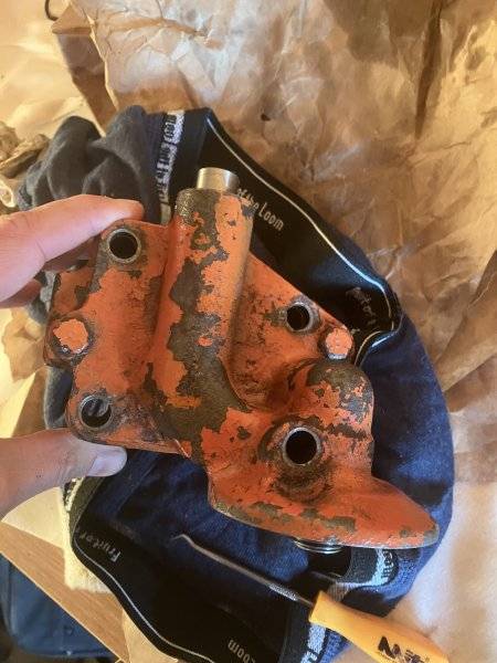

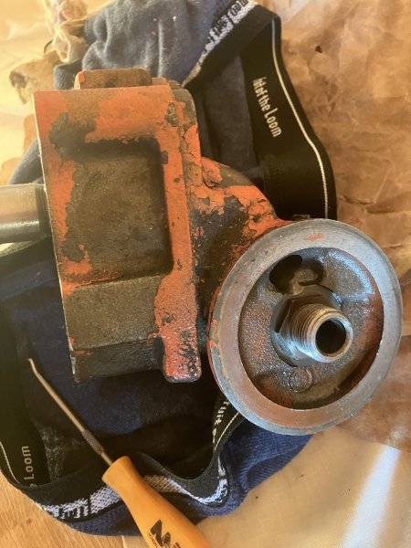

I’m going to post photos of the pump in a couple hours. Glad to have you guys here. All I wanted to do was fix a leak not get a migraine!

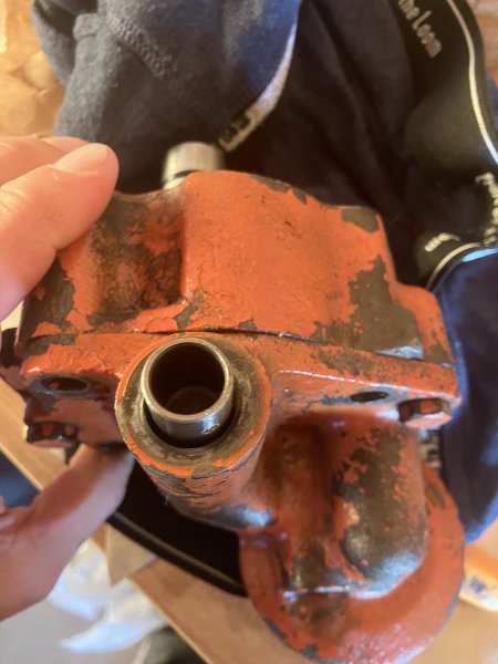

You might have that piston in upside down. The cap would be very hard to get on if you get it backwards. I thought I got that spring tester in Michigan. But I really don't remember.
The relief valve piston the springs seats in is installed with the opening they looks like a mouth at the bottom. Furthest from the screw cap.

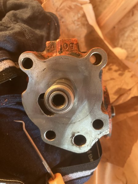

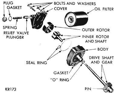

The issue is what O ring goes where. Between the two pump halves I have two option, skinny or fat.
I think they only look right one way. If you put the fat one on the shaft it probably won't go in the block. Put the skinny one on the shaft and then try to put the pump in the block. That will make it obvious to you.

Not on the shaft, the larger diameter o ring in between the two plates. In fact there are two inner O rings, a small and a large diameter. My thinking here is it doesn't matter. It's getting smashed anyway so go with the thicker one. The one on the shaft does matter. And I'm pretty certain it's the thinner option because like you said it looks right.
You already know the large one goes between the plates. The skinny one goes between the plates of a Milodon.
Let me try this again.
The kit included TWO large diameter Seal Rings (in addition to the small diameter O Ring and Seal Ring). As shows in Delta V's pic above. The two options are of different thicknesses. The job only requires one of these large diameter Seal Rings, it goes between the pump plates.
The LARGE diameter Seal Ring is the issue. Although the kit says which to use whether you have a stock or aftermarket pump I do not know if my pump is stock. I am just going to smash the thicker one in because why not.
