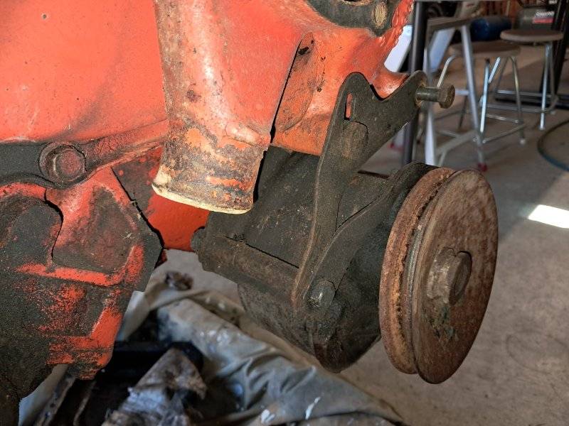

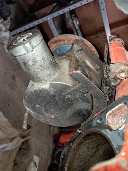

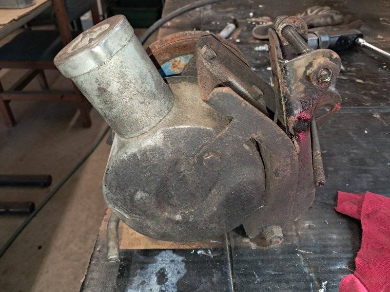

Pictures of my 1967 440 large TRW. Pulley bent badly and shaft possibly bent. I agree OP has small TRW.
Not sure how close 440 brackets are to 426 hemi brackets.
Thought I would post the pictures for reference.

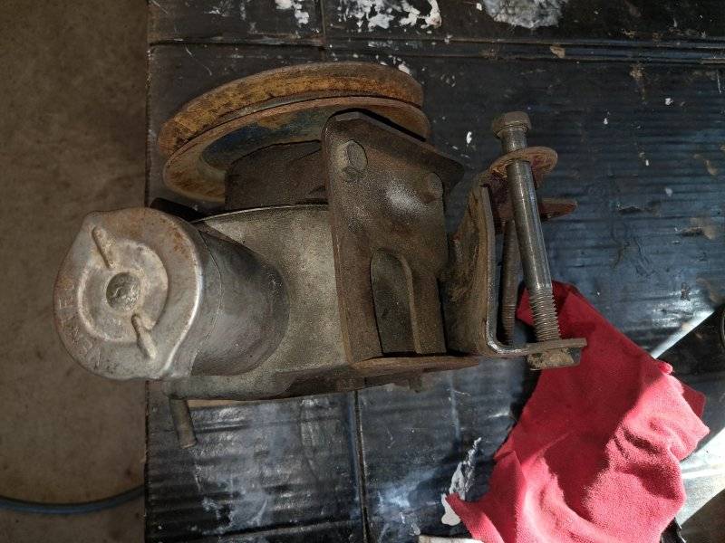

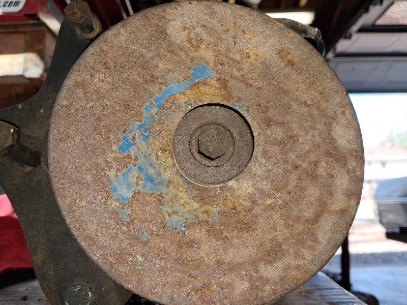

Thanks for the pics. The bracketry is definitely different. I agree, very sure I have the small but doesn’t look original either. The brackets on mine had turquoise paint under the black respray.
Those pics are a c body bracket
There are two styles of TRW brackets. I have both styles here. The ones shown on that pump are early ones, used through about 1964.

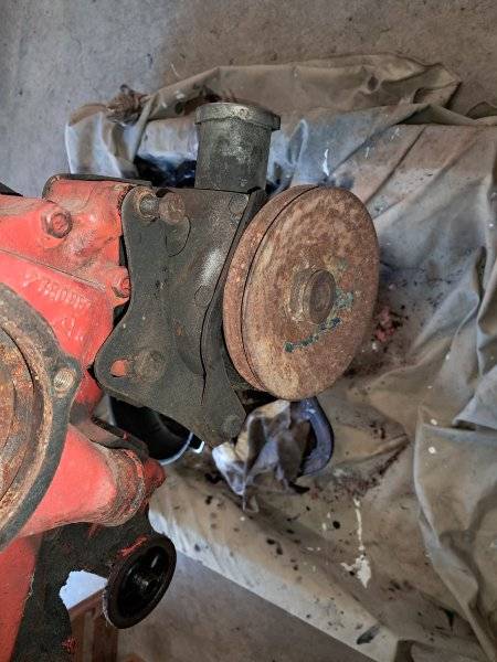

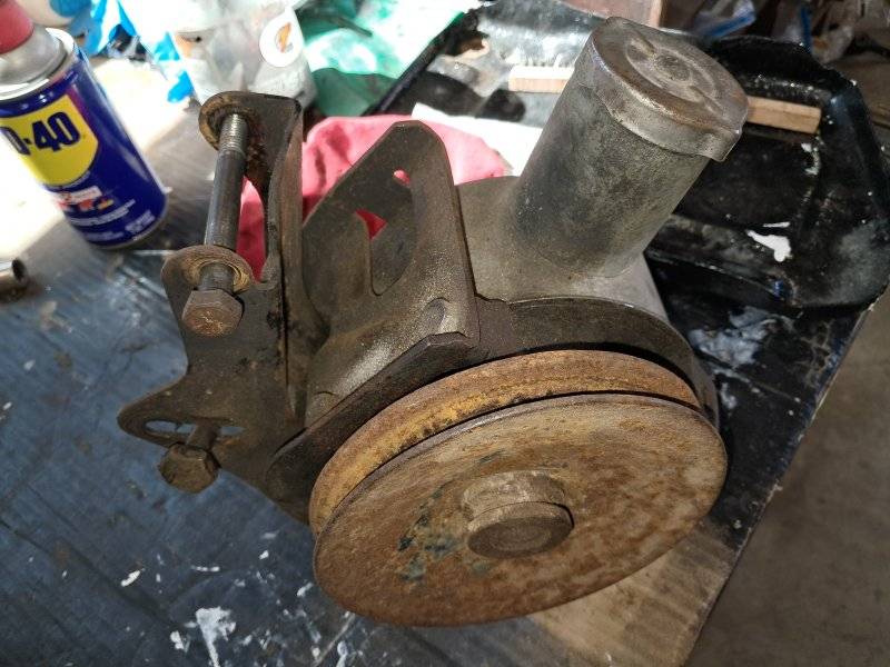

I bought a 440 non-HP engine and 727 trans, assembled and already oiut of car. Engine block Stamp code C440, Casting date 10-28-66, so block is 1967. Heads are 915, which matches 1967. Intake is 2806178 1-5-67 cast date. Oil pan is 187, which does indicate C-body, but fits a lot of years.
Engine and trans have been out of donor car at least 4 years, probably much longer. Donor car is unknown. Owner prior to the one I bought the eng/trans from is passed.
On the TRW pump and brackets:
C-body cars started in 1965 model year.
If the brackets are 1964 and earlier, they can't be C-body.
So I am asking, are these 1967 C-body brackets? Or are they much earlier B-body brackets that someone bolted on?
It might be a case of where it was assembled, or what was in the parts box that day. Obviously two different suppliers.
That's a c body bracket. Also, non hp 440s did not come in b body's.
I have the one with the 5/8 inch return. I put a little power steering fluid on the seal and the can and used the rear bracket bolts to slide on the can. No leaks that I see so far.
