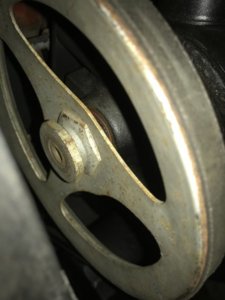

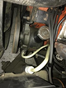

I have a Federal and was looking at seal kits Rock Auto and they only list Saginaw or Chrysler. So are the TRW and Federal both Chrysler and do they share the seal kits?

Edelmann 8507 Federal PS Pump Seal Kit is one that works from Rock Auto. I have used it. TRW is different despite the same appearance. Many sites confuse Chrysler/TRW and Federal.

My car is 74 with a 68 383, god knows where the pump is from. I took a chance and ordered the Chrysler kit listed for big blocks. It’s a gates #351270 kit. No plans on going anywhere soon with weather here so I might just pull the pump tonight and have a proper look.
Is there a way to identify which size pump I have, then which kit I need if the above wont work.
It looks like it’s leaking from the large seal where the pump meets the reservoir, are these all the same size at least??

Book will show the signs...how to tell which size. The pump can needs to be in good shape to seal. I had to do some work on mine.
I 'think' they will be a same size...just an o-ring. Main difference in the kits is the shaft seal size.
Above is not true for Federal. There is only one Federal pump size and kit. The TRW type had different sizes. But that is a different pump. If you have the threaded shaft you have the Federal.
For TRW the different size was the capacity and that was can size so there would be different sized O ring. A google search will tell you how to distinguish the Federal which became Standard with the Saginaw around 69. TRW was the early pump type hence why different sizes based on car size.

I already had a google and mine seems to be the federal. Also sure it has numbers cast on front of the pump.
I’ll pull it later to have a look. Will gates kit be ok if I have the federal then?
Did you type number correct? The Gates 351170 listed as Chrysler is correct for Federal Pump.
