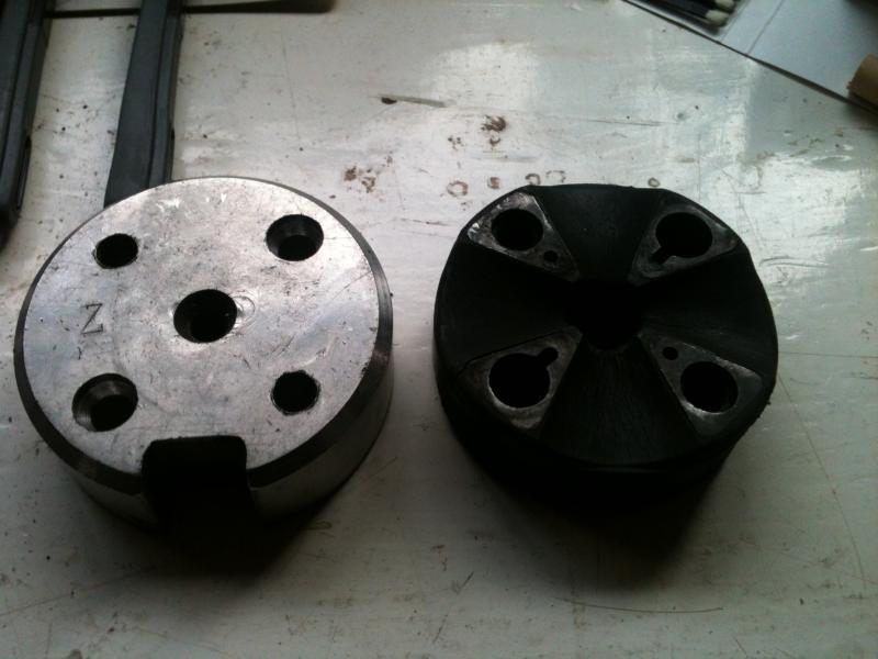

IMG_0445.jpgHere is the fix. Made this out of a chunk of boat drive shaft. The 2 holes look different than the others because I counter-bored them to match the original piece. The opposite holes were done the same way on the other side. I'll let you know how it works

Well, that didn't work as well as I had hoped. Got it all put back together and went for a spin. The slop in the steering was totally gone, but there was a tight spot at the same point in the steering on each spin of the wheel. I thought maybe I had overtightened the sector shaft last summer, but after monkeying around with that for a while it did not make any difference. After taking things back apart it looks like that replacement I made for the rubber biscuit is not as flat as I had thought. It was too big to chuck up in my lathe, so I just tried to get it flat by eye with a disc grinder after I cut it last week. I supposed that wasn't close enough. I'll take it over to my buddy's shop and use his big industrial lathe to get it dead on and then try again. By the way. I'm a new guy and someone on my other post asked for some pics of the car, so here they are. 340, 4 speed, 3.55 sure grip. Original color and stripes redone in 1997.View attachment 100729View attachment 100730View attachment 100731

hard attaching the box to column can cause binding.hopefully after you remachine the disc it will go away.rubber discs and flex collars allow for a bit of flex.adaptors eliminate the need for flex with smooth rotation at slight angles(purpose of the ujoint style adaptors)if it still binds after you machine it,you may need to make something else.
The original shaft couplings, both up thru ’72 and ’73 and after rag joint, also provide for some slight fore and aft movement of the steering shaft that will be lost with a solid rag joint disc.
The column has a normal mopar pot coupler above the rag joint, so it can still move fore and aft a bit and accept slight misalignment. The only part I was trying to eliminate was the rubber disk.
