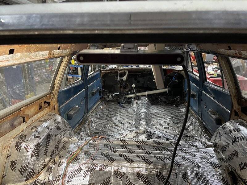

Just something about having a stick. I am working on a 69 Ply Wagon with the 440 6 pack and a 4spd right now and its very cool to see that shifter coming up into the car.
