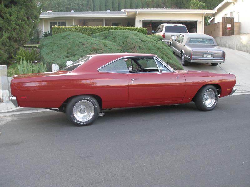

Looks pretty much stock to me.
Me thinks your torsion bars are lowered in front, like mine . At least it's easy to lower just by putting a spacer on the spring perch.
my shackles are 31/2" center to center. I think it looks great like that. Now if you had 17's on it and lowered it around them , that would be another story.

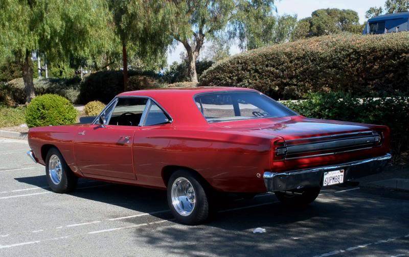

Hey D575, is your RR a 68? Looks to be the bright red. Nice wheels!
69 in the first pic....rear springs look like they might be SS springs.
