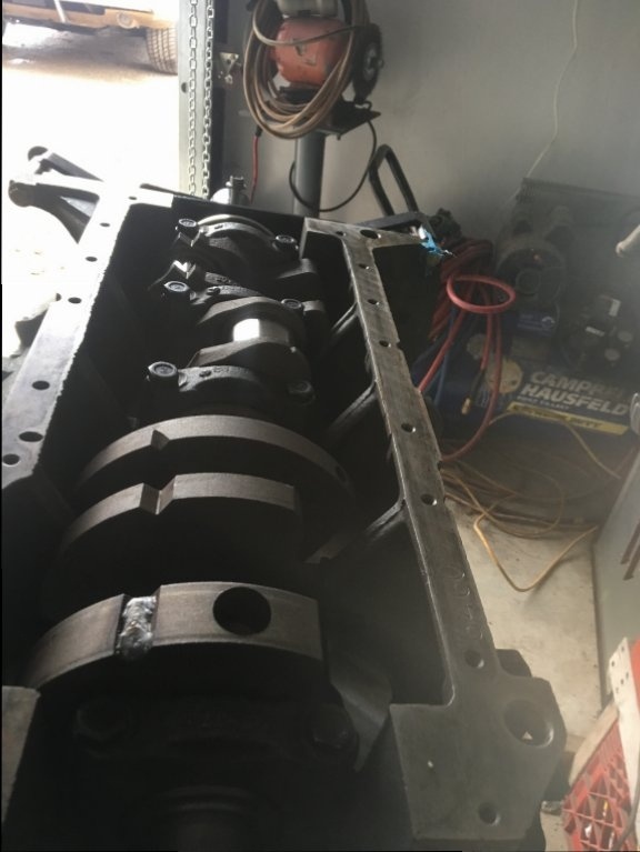

rebuilding my 67 rt s 440 the plan is to keep as stock sounding and looking as possible but also adding as much punch as I can this one a bit new to me my other cars either didnt need engine work or we didnt care about keeping the stock look or sound anyone have advise been brousing the web and mostly find big horse power ideas

keeping stock heads, intake, exhaust, its a 67 rt with 36k so keeping it very original but since it sat since 74 theirs some rust piting on two cylinder walls at top so going to have to bore it. I dont think hone will do the job, and if im doing that might as well go a bit farther .

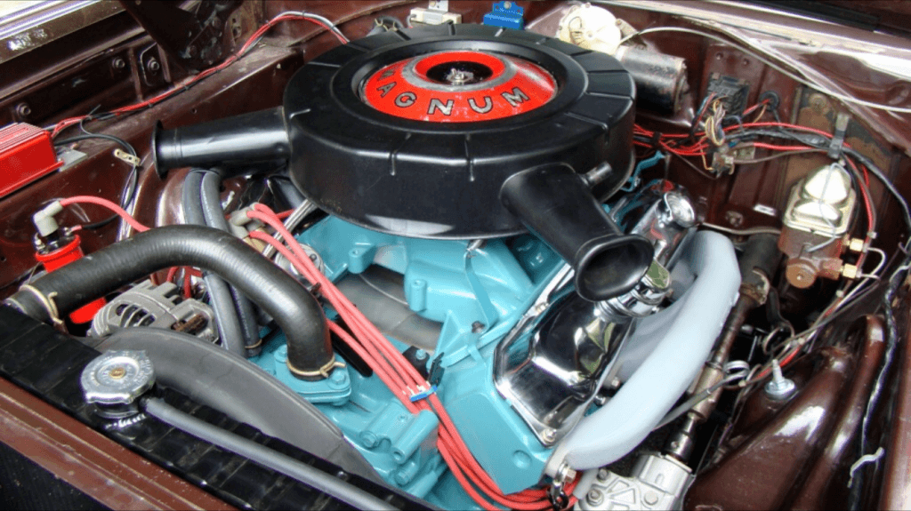

Look at bs67 his 67 factory 440 charger looks stock under the hood but runs 11s.

the pic of the charger looks great and im sure its a blast to drive . mine wont be anywhere near a 11 sec car
this old girl is getting restored and every thing original except some internal engine components and I wouldnt have even opened that up but it had some blow by. Didnt find bs67 member on here to chat with
