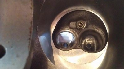

Never mind on the magnum heads just picked up a set of 340 x heads that have had new springs , valves and a little bowl work for $300 yesterday . Good score I reckon .
Good score. Would be nice to know some flow numbers, but if they were done right in the bowl work they should flow in the 240's cfm.
Man, that's cheap....but....iirc, the 2.02 valve is a bit too big for the teen and will touch the cylinder wall. Maybe someone else will chime in with that. I never have done much work on small blocks but the 340 head is for a large bore. The 340 engine has a larger bore than even the 360 which is 4". The 340 bore is 4.040 stock and the teen is only 3.91
It won't hit. plenty of room.
As for the chamber size, they are usually smaller than the bore sizes of the two 340/360, so though very close ... won't be a problem.
I like to scribe them and blend them to the bore size of block used.

A 2.02 in a teen will be fine.
