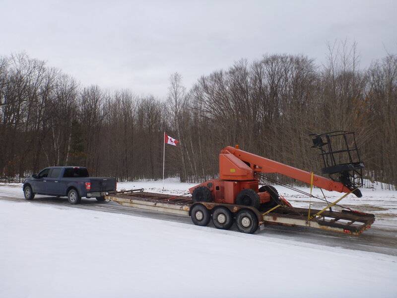

for those here with a car trailer, I recommend not parking it on anything with a car on it.
those six plies cracked,separated, and went to hell after one winter.
and they were low mile tires only a few years old.
Finally had one out of six go flat this Spring on my 34' triaxle. Road King bias plies. Bought the trailer Feb 1990 (to haul the Bird and Bee to shows), original tires. Always parked on boards.

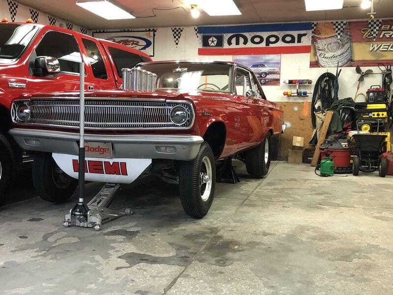

Almost afraid to post, but this is how this unit sits 99.99999% of the time, granted the wheelbase is a lil' shorter, but the frame connectors are fully welded to the floor (boxed), and the doors open and shut the same as on the floor or on jacks.
gorgeous color! In 1969 my little brother had that exact red coronet Hardtop with a 318 poly.
floor console,,,,, it did not survive Him!
