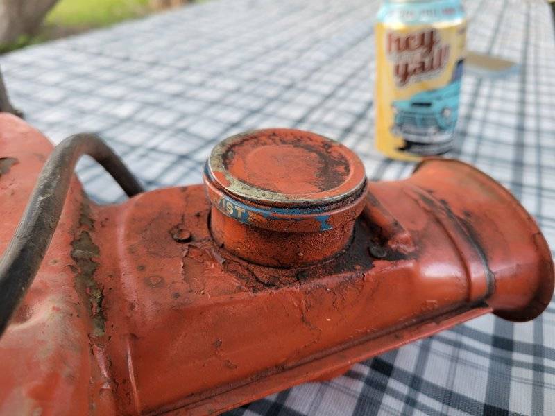

I want to block off the stove pipe hole in a dual snorkel air cleaner as I’m not going to use the stove pipe and I would like to keep warmer air from the headers out. Any idea’s on how to do this. @kiwigtx duck tape is not a solution.

What are the ID and OD?

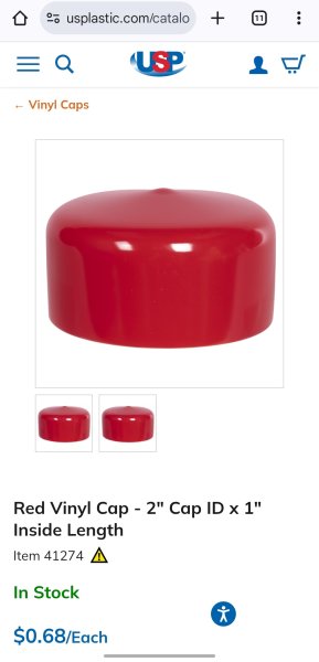

Spitballing:
1) high temperature silicone cap or plug.
2) expanding foam
Here is a vinyl one. You should be able to find something in high temp silicone.
The stove pipe inlet is next to the snorkel inlet. So, I'll have to ask you this question. Do you think it's going to make any difference ?

Probably not. I originally thought in my head the opening pointed down, and then when asked to post pics I realized it wasn’t, but it was too late to delete the thread.

It's not a bad thought, it's practicality is whether it's worth the bother. You got a beautiful air cleaner, I'd leave it as is. ( Ya gotta be a car guy to describe an air cleaner as beautiful :lol: !! )
That’s the ticket right there. Now if I can just find one in hemi orange. :thumbsup: :lol:
