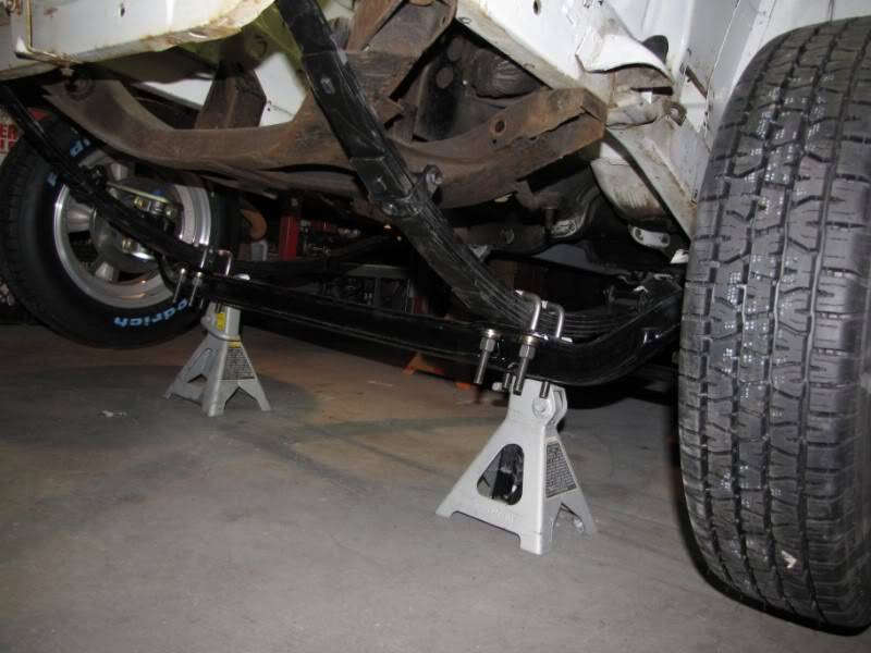

Polara Pat - Here's another idea for you, if you don't mind a little non-Mopar mix-n-match (gasp!!) I know...
I am using a 55-59 Chevy pickup truck axle on the 62 Belvedere I am building. Chevy parts like repop spindles, kingpins, and disc brake parts are a dime a dozen and readily available. The Chevy I beam is 54 inches kingpin to kingpin, with discs will give you a 62 1/4 inch hub to hub width. (one inch narrower than an uncut A100 setup)
The chevy axle uses 2" wide springs, I am using new Jeep CJ springs from skyjacker. A saginaw 525 box will handle the front steering setup. The K frame is coming out, different motor mounts are going in
I am just finishing the parts collecting, will start welding stuff in pretty soon. Here are a couple mock up pics, etc.
