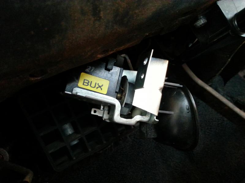

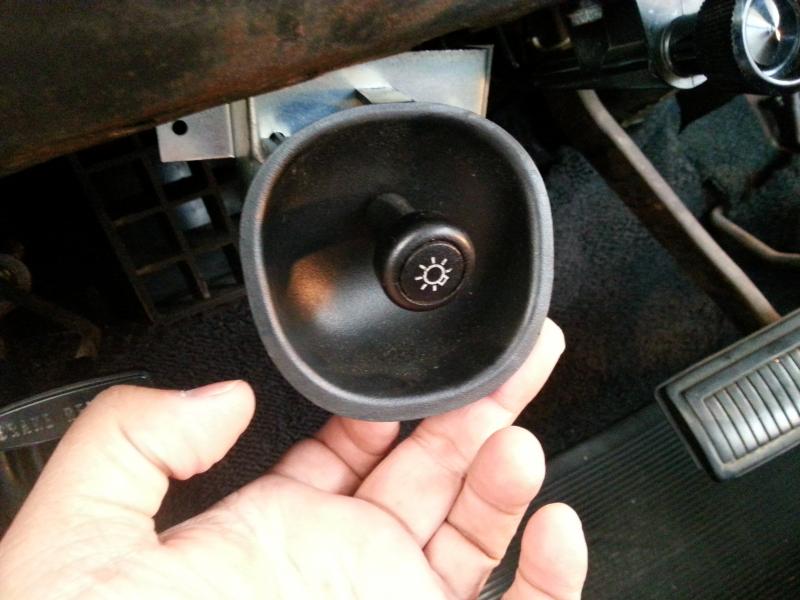

My mechanic mate and I jumpered the headlight switch..BAM! Lights turn on..
SO here is a novel solution if you are ever in my situation, need to order new headlight switch and/or it's making it's sweet time getting to you. CAVEAT, this only works if you have a decent 'parts' bin full of Chrysler cast offs..
My mate dug about in a box full of LATE model Chrysler gear, he found a NEON headlight switch..Well what do you know, it is a direct copy of the ones in our cars! Ok there are a few more blades on the NEON switch block, but take it from me..and these photos, it is a direct fit for my '67 Coronet headlight loom! I was amazed..
OK it is hanging there at the moment, but I get my new switch on Tuesday and now..I can still cruise this weekend and have LEGALLY working headlights!
