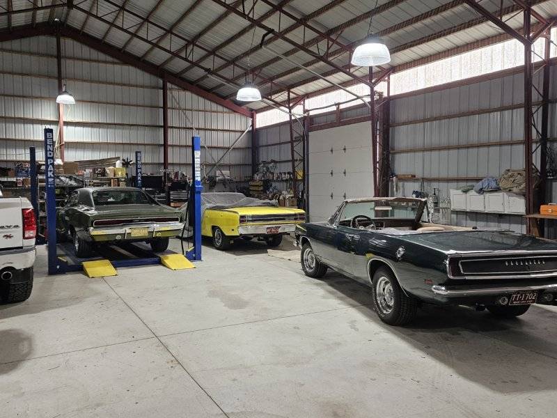

Got the new cable installed and took her for a test drive. Speedo is smooth as butter! Of course while I was under the car I found the trans cooler line resting on the exhaust. Kinda hard to cool that way. And as I was installing the cable I reached under the master cylinder and my hand came away wet with fluid. Fortunately it was just the cover screwed on crooked. Think I'm gonna need a bigger pole barn.
