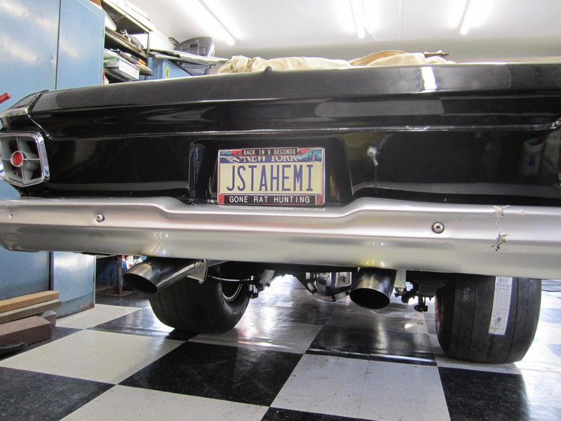

What kind of exhaust do you have? Headers or manifolds? What size?
Maybe also could be trans input shaft bearing.
It's the deadly flushmaster drone:blob1:
