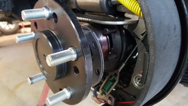

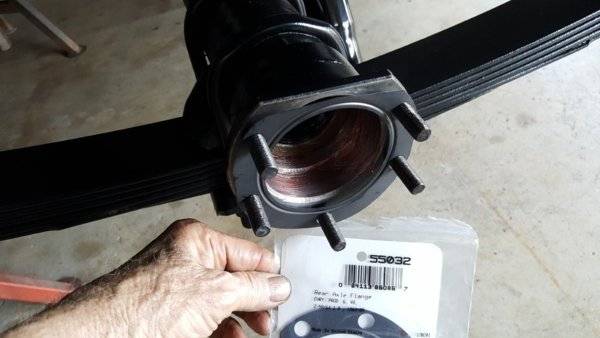

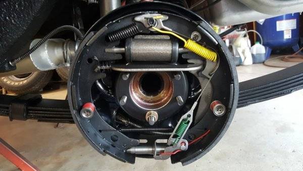

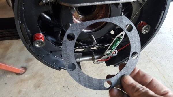

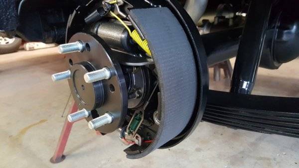

Here is the order...
Axle housing
Metal shim
Backing plate
Foam/composite shim
Axle
Tighten the the nuts
Move to other side
Axle housing
Metal shim
Backing plate
Foam/composite shim
Axle
Move to other side
Now ya have pictures to go along with the instructions, lol!!
