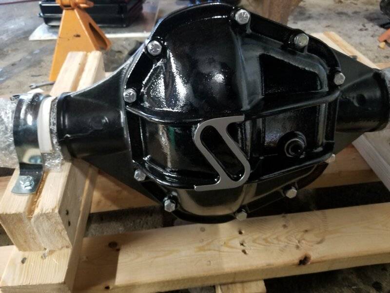

Any of you guys purchased a complete Strange S60 from Dr. Diff or directly from Strange for your B-body? Thinking about getting one for my Bee project that will have 550-600 hp. Did you go with the standard Trac-lock or upgrade to Truetrac or Detroit locker? Were the gears set up nice with no noise?
The '71 Charger has the S60 4.10:1 with spool and 1350 Yoke. No issues, but I did not care for the axle end hardware (the bolt/studs that hold the axles in and the brakes on.)
https://www.strangeengineering.net/wp-content/uploads/2016/04/b1300hskit-1p.jpg
I replaced those studs and nuts with the Mopar style.
https://www.doctordiff.com/mopar-housing-end-stud-kit.html
Ordered mine with 4.10 on Black Friday super smooth with the helical set up
