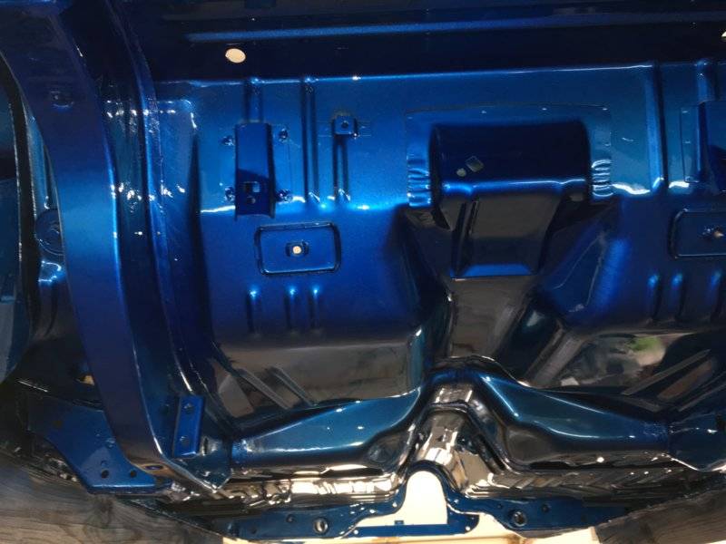

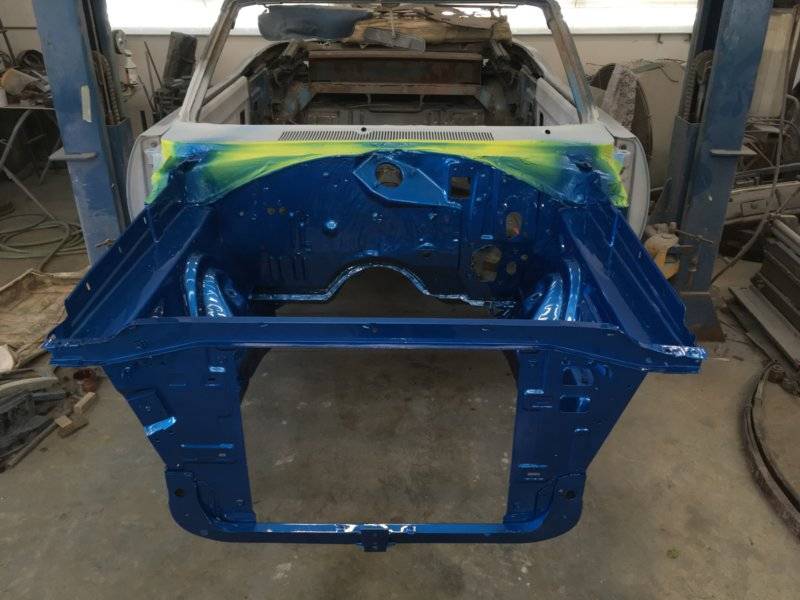

Thanks! I have the pump and brackets/ pulleys and a steering column with coupler. So other than the pitman arm I think I have everything needed. I just got paint on the underside and engie compartment yesterday, so it's time to start getting the suspension back under it.
