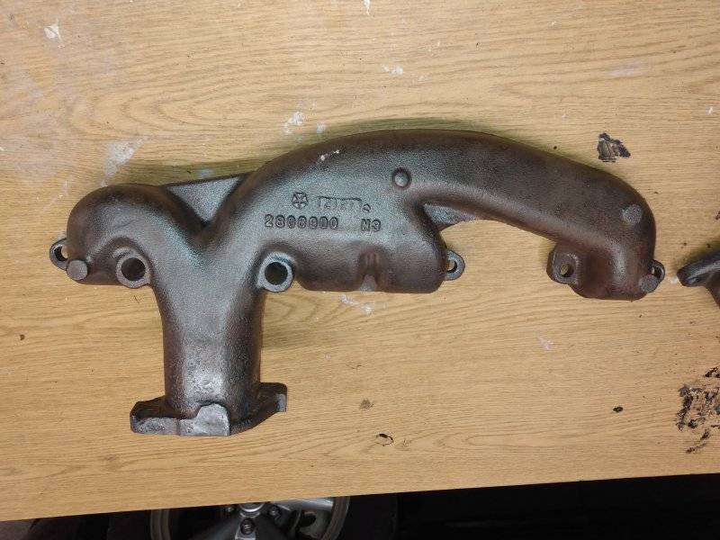

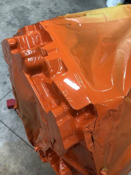

Here's an extra 5.7 Hemi exhaust manifold I had laying around, that I decide to use as a proof of concept/test piece.
I was checking for overall appearance, and to see if there were any obvious negative chemical reactions and so on.
The "basecoat" is rattle can VHT street hemi orange, and Mopar Performance Turquoise.
The clear is the same budget friendly FC720 as on the engine pic above.
Both were very thoroughly dried and cured, and scuffed lightly with scotchbrite.
The clear gives a pretty satisfying increase in gloss.
At some point I'll try some gasoline/carb cleaner/brake cleaner and so on, to see if it holds up.
may try to do my next complete engine with this concoction.......
