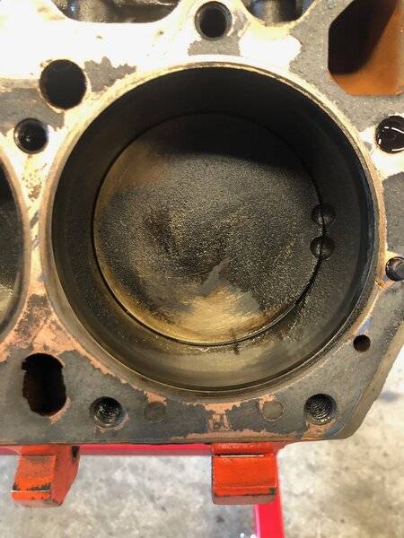

73' Block (J Code) Block is factory bore(4.32) and has a flat top piston with 2 little relief's that face the front of the block(See Pic). The pistons are .161 down from the deck at TDC on #1. The motor had Felpro 8519 PTI or PT1 head gaskets. He was running the Howards 728001-09 cam and that was included in the sale and what looks like a brand new set of factory style rocker arms & 3/8" pushrods.
I actually enjoy the Lunati 60304 cam but I have a feeling it was not degree'd properly and the whole engine since day 1 has felt like a dog. So I dunnno.
Looks like Step 1 is completed: 7.8:1 compression ratio with an aluminum head. Not a great starting point.

With the pistons that far down.
It's an uphill battle. (so to speak)
