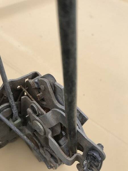

View from the top, fully latched.
Roll down window, insert a push rod here. You can see this from above, I've verified this on my 73 Satellite. Push down.

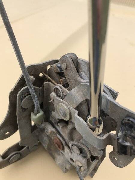

View attachment 1105375 View attachment 1105377
This is a 1/4" metal rod, A 3/8" might be better, 1/4" drive extension also works.

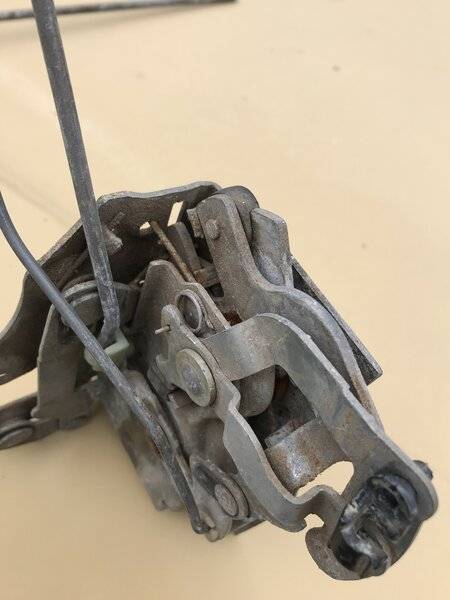

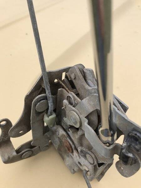

How it looks pushed down and fully released, notice the gap in the latch levers at the top.
Hard to see this through the window gap at the top of the door. While pushing the rod down try opening the door. View attachment 1105376
