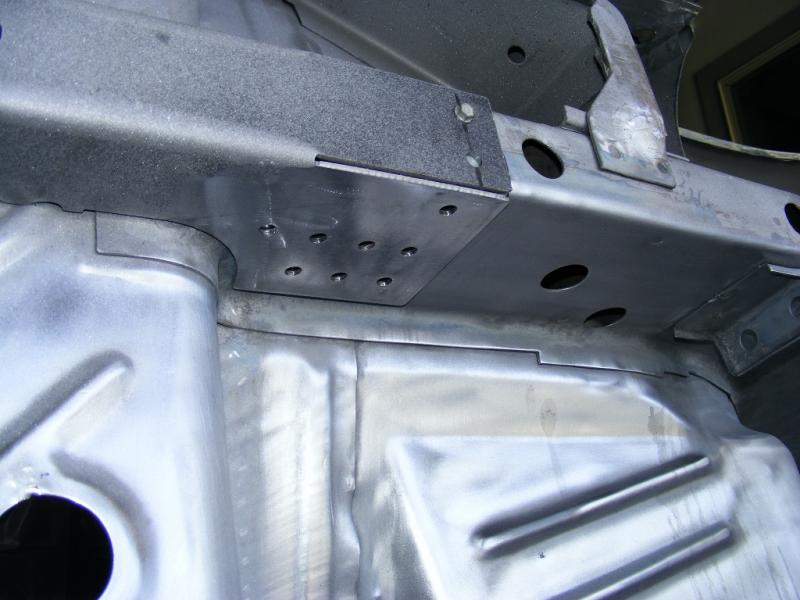

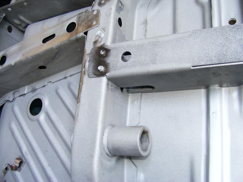

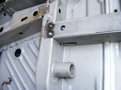

When I put mine on last year, the car was on the rotisserie so I fit them to the bottom of the floorpans and used sheetmetal screws to hold them in place. I then set four jack stands on the concrete floor and leveled them front-to-back, and cross-ways so they were all on the same plane. I used some 1/16", 1/8", and some sheet metal pieces to get the stands at the correct height. I put the stands just outboard of where the connectors will be welded, and set the car down and off of the rotisserie. The car sat down firm on all four stands. I crawlwd underneath and tacked them in place at the ends first, and then every six inches making sure that everything stayed cool. I put it back up on the rotisserie and turned the car completely over and finished the mig welding. Patience, Patience, Patience. Here are some pics.
