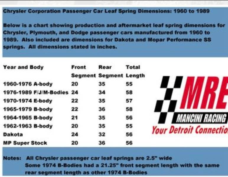

OK. But I believe the hangers you are recommending are for a dodge and not a plymouth. I see that mancini is offer hangers for a 65 Plymouth on their web site.
the mancini website states that the ---97 bracket can be used for 64-65 plymouths. give them a call to make sure the website is correct. if they have something that fits a 65 coronet with stock 21" front segment it should work on a 20" front segment 65 plymouth.
my post on section#8 was wrong its 20 not 21 for front segment length.
why buy extra if you dont have to ?(66-72 22in ) on the short side of the spring measure from center pin to center of bushing .
super stocks are 20 you should not have to drill anything ( if ) you need the bracket . the superstock springs where designed for our cars as most of the parts where (62-65) ! if you had a 1966 up then it would be a different story . i know what you need for your car but if you measure you will get a better understanding of how things work . happy mopar building!! easy peasy
yes you need to change hangers, front segment of the super stock spring is 2 inches shorter. mopar part # is P4120080 for hanger I cant remember how much they were.

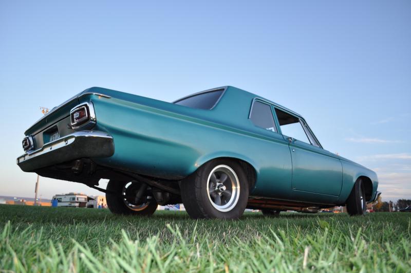

The SS spring is too short without an extended front hanger on a later B body.
Your options are a longer front hanger or a set of sliders to replace the rear shackles. I have SS springs on my 64 Savoy without any extra long hangers but the 64 uses a shorter spring total length. I have a set of AR Engineering front spring hangers that will give you another inch and that may cure your binding issue. You can try them if you want just let me know.
Gus
