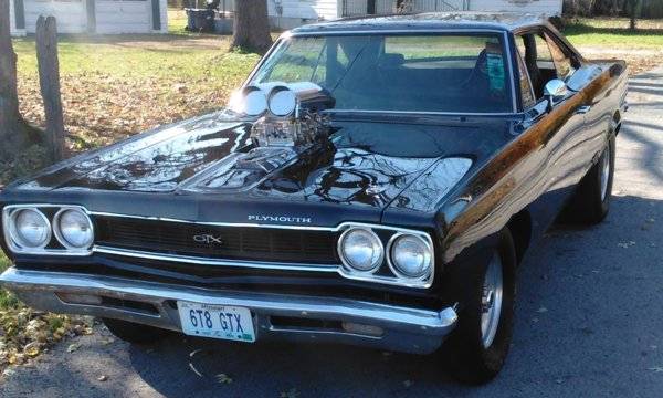

So my priorities somehow got mixed up... added A/C, serpentine setup, stereo....this is all great and adds to the reliability, comfort and enjoyment but doesn't do a thing for going fast!! I've been looking to add some ponies to the Charger for awhile but do to my lower cruising rpms the normal route of obtaining more HP isn't an option so Supercharging is on the table.
The purpose of this thread is to get everything that will be needed on the table so I can get a feel for the cost before I dive in. I'm only a few days into researching this so here's where I'm at.
Goon being the instigator that he is offered me a deal on a D1 which more than meets my goal..... and sparked a real interest (intentional I'm sure:rolleyes:) so that would be covered.
I have a super nice Quickfuel Q series carb that will cost $500 to have it reworked by CSU... Please all you EFI guys resist the urge to sway me towards EFI... I like nut and bolts not computers lol.
Brackets will be custom made to run it off of the existing serpentine kit. This will likely require me to machine all new 8 rib pulleys as well since mines only 7.
So the rest of the list??
Boost reference regulator.
Aermotive electric fuel pump.
A/F ratio gauge.
Water injection kit?
Carb hat.
Blow off valve.
I'm getting mixed input on ignition, one says with water injection I'll be fine the other says I need a fancy ignition where I'll use a laptop to view and modify the curve $450?
So what am I missing other than plumbing?
Goal is to go from 500HP to 700HP and do it reliably meaning out with the Hyp pistons for forged and better rods.
