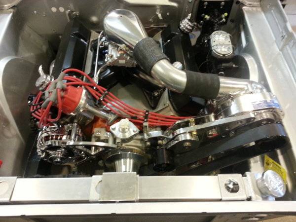

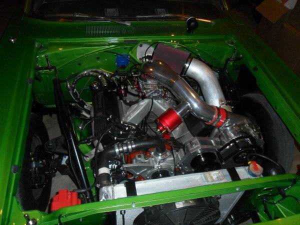

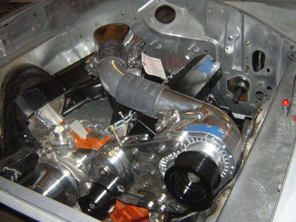

View attachment 544112 View attachment 544113 View attachment 544114 View attachment 544115 View attachment 544116

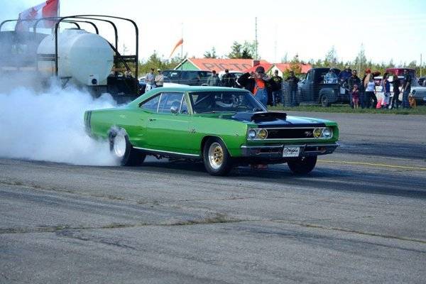

Yes.. all with true - EFI. EFI.. EFI... Ask them next time you see them, 'daily driving', how much have they invested in their builds. . . Easily $6,000+ for the complete kit from thesuperchargerstore alone. Then another $2,000+ for a proper fuel system (EFI). I believe the blocks can handle a bit more than most claim if the tune is spot-on, but then again, I wouldn't leave anything up to chance when starting a build like that; always have a safety net. Just my honest opinion.
BTW, F2 Procharged 440. Daily driver myth debunked, guy is expecting a single electric pusher fan to keep it cool in traffic. Must live in Alaska. lol.

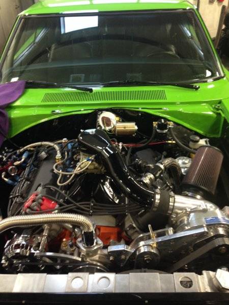

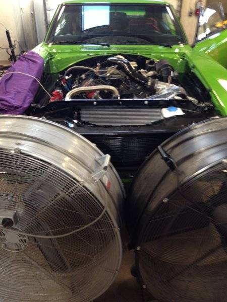

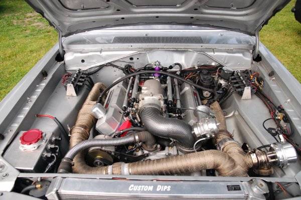

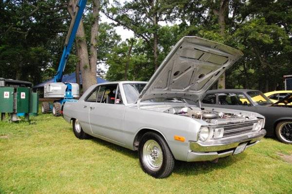

I thought I would add some pics for you Dev. I think you have seen these before.This is system that I had before I switched to injection and the fuel system I sold to mike AKA GOON. This system I put 840HP to the tire with the carburetor. Not sure if GOON was including the fuel system with what you guys were working out.one of the pics is when the car was on the dyno. I have done 70 pulls on the dyno. With the carb
I did 12 pulls to get to 840hp. The other 58 where to get the injection dialed in.LOL

I did the 12 pulls with carb and had a piece of rubber stuck in the fuel pressure regulator. So we leaned the jetting to compensate ,the car did 750 that day.I took the car back to my shop and fixed the fuel system and went back and did the 840hp on pump gas.
I ran 14.9 pound of boost with the carb set up no intercooler,pump gas and water meth.The Injection system was tuned on pump gas as well but intercooled.

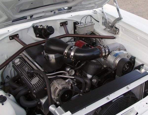

Sweet5ltr that video of the F2 Procharged Coronet was taken in 2012. Car has been on the road ever since and drives 3 hours round trip a few times a year to an old airstrip for armdrop drag races.
You should have a look at Dev's build thread for his car. there's 104 pages so I doubt you want to sit there and read through them but gives you a good idea of his familiarity to tackle a project.
