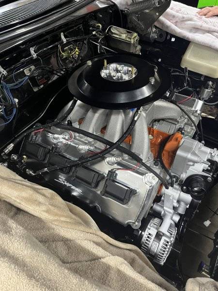

I am doing a budget build 5.7L hemi with an 8 speed 8HP70 to take advantage of the 8HP's .66:1 OD ratio. I did the math on rebuilding the 340 that i have in it and adding a GV's OD. and the costs for a budget build are similar. I budgeted $9K and have been tracking the costs to date. The most expensive part is the Hotwire harness and ECU mods, since I've gone with a non-factory combination. the 8HP70 was never supplied with an early Gen III hemi. that was $2,650 for the wire harness, and trans controller. I bought a 2006 Dodge Charger that had just had a rebuilt engine installed, and then that owner subsequently wrecked, for $4K. I pulled the motor and sold most of what I could for a net investment of $1,500 bucks. Could have bought a motor for less than that, but this one had less than 1,000 miles on a rebuild. So far, using Holley tranny mount, hooker blackheart cast manifolds, holley cast oil pan and a lot of salvage yard scavenged parts (2006 commander alternator (smaller), angled oil filter adapter, etc.) and i'm under budget by about $1K so far. I budgeted for all new parts, but have been able to scrounge stuff. I am doing all the work myself, so that helps tremendously. If you want more details, happy to share what I know. This is still in work, so final tally is not done. This also included the cost of HP tuner to tune the ECU for future mods.

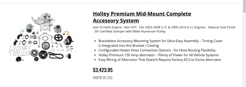

The 5.7 I have is still in my 2007 truck and is still running great even at 407,000 miles. Of course, it will need to be rebuilt so a longer stroke crank kit would be great. Still, it is a truck engine so the oil pan is wrong,
and so is the front end accessory drive...add in the costs for those:
That alone makes it a deal breaker. NO way I'd pay $3400 + for all of this stuff. I'm at $4300 just to get the engine in place and I still don't have a computer to run it or a fuel system to feed it and the engine internals have not been touched. No wonder people go BIG when they do this swap....They must figure that if they're spending $6000 before ever touching the inside of the engine, they might as well go all the way and use a new crate engine.
