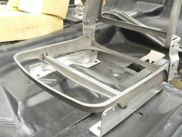

I realize that there is a difference between true superstock seats and the A100 van seat. Will these re-popped seat brackets fit both seats without any modifications or just the real superstock seat?
The center to center mounting nuts are approximately 14⅜" on the A100 seats. The center to center holes on the seat brackets is approximately 12¼". I've seen the brackets mounted close to the outside edge of the seat and others mounted inward, apparently in the factory slider location. In order to use the factory spacing, a flat strap of some type has to be used.
Are you using the Gary Ball brackets? Maybe his aluminum brackets are longer than Kramer's and ssandafx.
I can see moving the brackets outwards and drilling new holes and welding new blind nuts in. Plenty of material on the side of the van seats to do this. If using the original van seat sliders, a stud needs to be welded to the bottom half of the slider. The factory A990 cars and the 68' superstock cars didn't use sliders.
I use the sliders on mine. Just made everything a little more convenient. I just used bolts on mine.

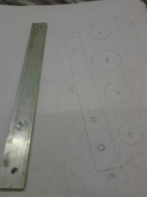

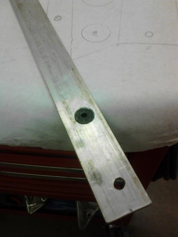

Since the superstock seat brackets I have weren't a direct bolt on for the A100 van seats, I made these adapters that will work with or without the seat sliders. Eight 16"x1¼"x¼" aluminum. With the sliders and race helmet on, I've got about 1" clearance between me and the headliner.
