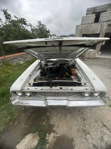

Hello,
I will be glad if any of you can share exact location of VIN tag locations on 74 Satellite Sedans.
Preferably with a sample image.
I am considering to buy a car but location of the vin tag is not on a usual place.
You can see on image. It's not on radiator support, it's on grill support and it's also not on fender as far as I see.
Your comments are appreciated.
Thanks
On my 2 door St Louis built '73, it's on the radiator side of the core support.
Not quite in the middle, about an inch down.
Also on the cowl in the vicinity of the wiper motor.
