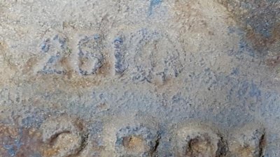

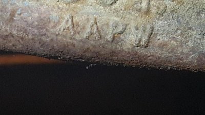

rear axle is off the ground since we're still working on the car. We can spin the one side but not the other because its seized up. is it worth rebuilding if not a sure grip?
If the one wheel turns easily, it may not be a SureGrip but it just might be one that's worn. Pull it out and see just what's inside.....then go from there. Any 8 3/4 is worth fixing if it's not a total piece of junk.
I don't think it has a sure grip
If it did have a working sure grip and one side is seized...then the other side shouldn't spin either.
