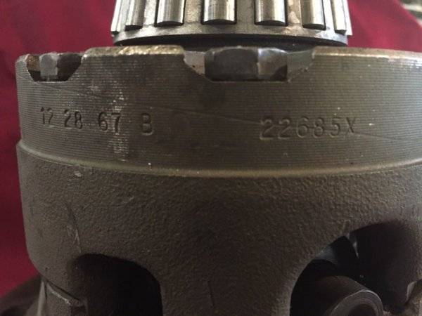

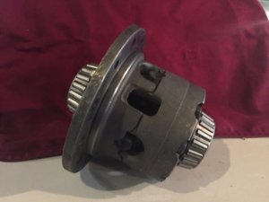

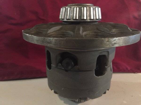

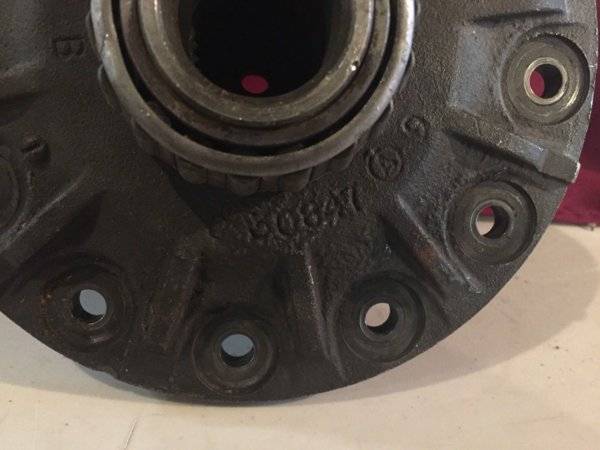

I just purchased this Sure Grip.. It has a late 67 date cast on it.
