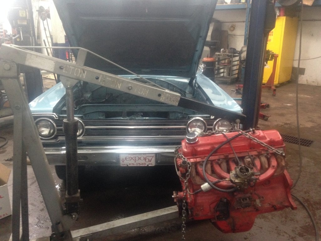

i have installed them on a tr 6 and really works well, how hard is it to get the torsion bars out to replace the bushing in the front lower control arm?here is my girl with engine out. winter is long here , so these ail keep me busy for while

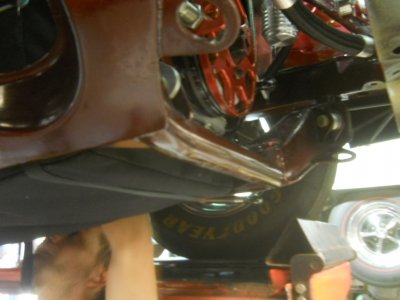

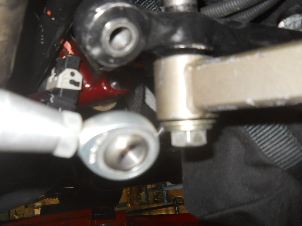

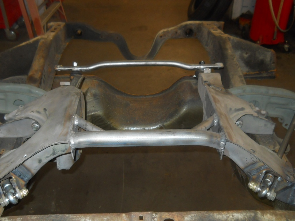

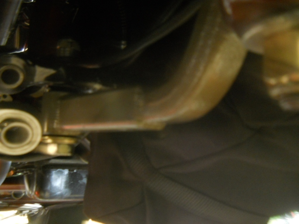

I was at Ray Bartons and went out for Pizza with Ray. I was discussing My son red lighting in the Finals. He told me it was the car more then my son. And showed me what they did on the Hemi SS cars. We copied it and will be putting it on.
This eliminates the wheel assembly being forced back when foot braking. When leaving off the brake the wheels lunge forward. They also extended the pitman and idler 3 inches to move the center link back ??..
Yeah - rubber mounted strut rods move around a lot. That's why urethane in that position is a good idea. I think the longer steering levers help with bump steer - like coming down from the off-the-line wheelstand. Can't think of much more it might do aside from give better oil pan clearance too?
