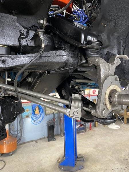

Getting ready to do an all out bushing etc rebuild on my 73 Road Runner.....does anyone sell a complete kit? I see partials but not a full kit.....also...are the rear sway bar bushings the same as the front?
Not sure I want poly but am not totally against it.....I would like new shocks as well.....trying to stay stock (or close to it)
Car has factory 340 with 57,000 miles...everything is ready to be replaced due mostly age....
Thanks for your help
