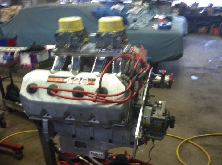

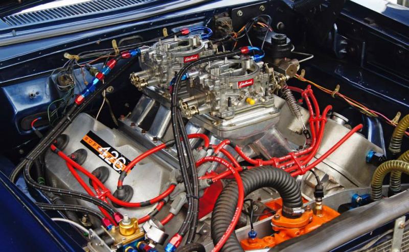

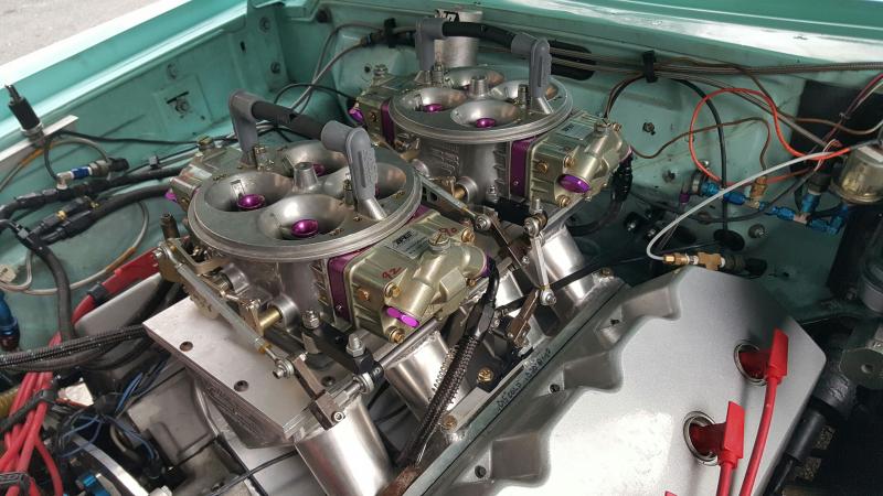

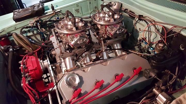

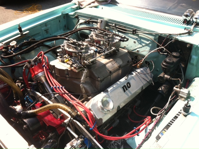

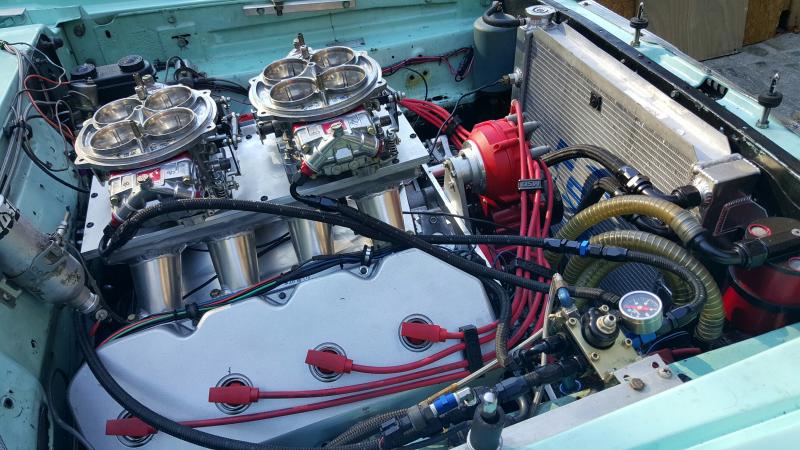

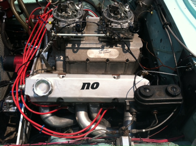

You're going to have to look at hood clearance 1st and go from there. I just got a indy tunnelram too for my wedge and i'm going Edelbrock 800's on top and making mine inline. With the sideways 4150, throttle cable is going to be an issue. Pedal feel, stiff, binding and not being comfortable. I modified a 4500 indy top for my edelbrock carbs.
I had to change over my gas pedal assembly and make up a new rod cutting through the firewall on my 65 light blue dodge.
My 60 foots are awesome with my edelbrock inline setup on my tunnelram intake. hope this helps

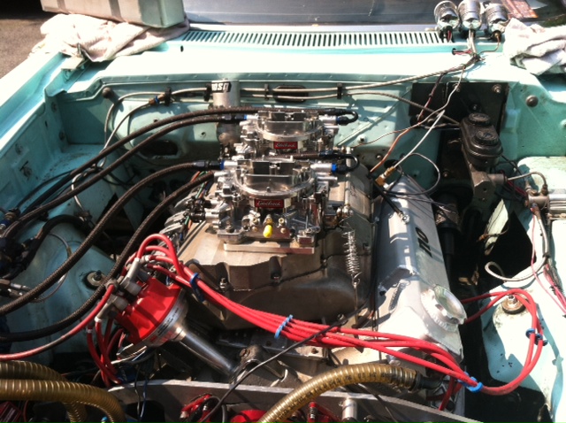

no the enderle linkage will not work for inline carb.It's easier and smoother, more responsive and you'll go fast. ill get you a picture of what you'll need.
pedal feel with sideways tunnelram is crap. Binds, stiff after 1/2 throttle. I went with a solid rod in my light blue dodge with sideways carbs. much better feel and smooth but it's a lot of work switching over from stock pedal.
Jus trying to save you a lot of aggravation.

here's a pictureof the throttle linkage on my 65 dodge with 2 edelbrocks or carter carb. Same principal

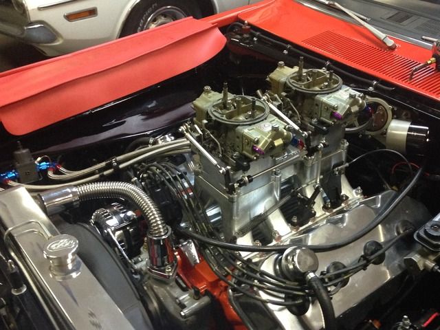

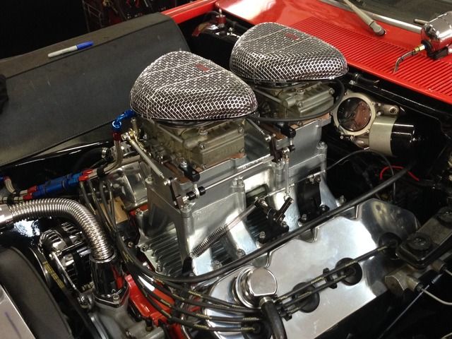

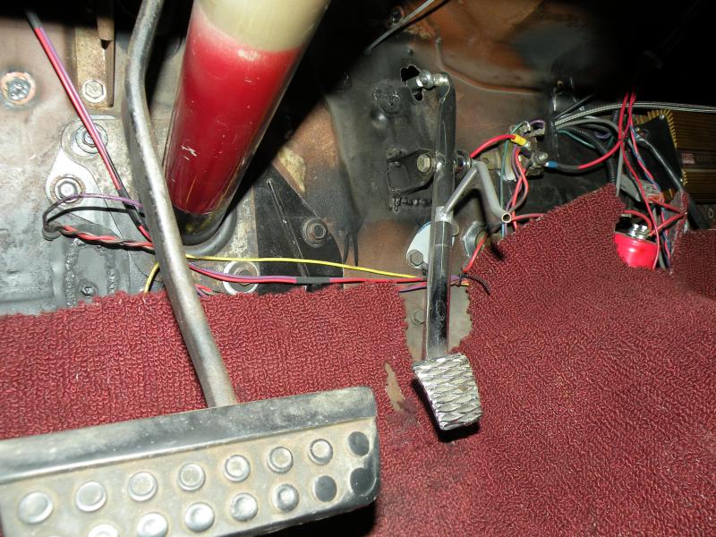

Like I said previously, my tunnelram sideways linkage was set up correctly with full WOT and it was fine at part throttle with my stock gas pedal and stock hemi cable. I had the correct geometry and normal return spring pressure.
As soon as it got past 1/2 throttle, the cable got harder and harder to press. So when I left off the starting line, it gave me a uneven feel and I had a hard time getting a good run in. After that weekend, I went with a aftermarket pedal and a solid rod. problem solved. Now it's nice and smooth throughout the travel.
SSR, happen to remember what brand parts you went with?
For what? I can get you a detailed description of everything you need.

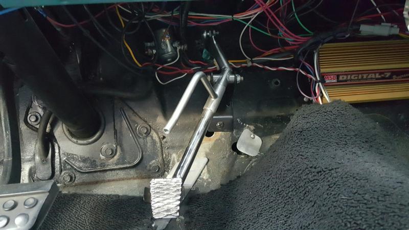

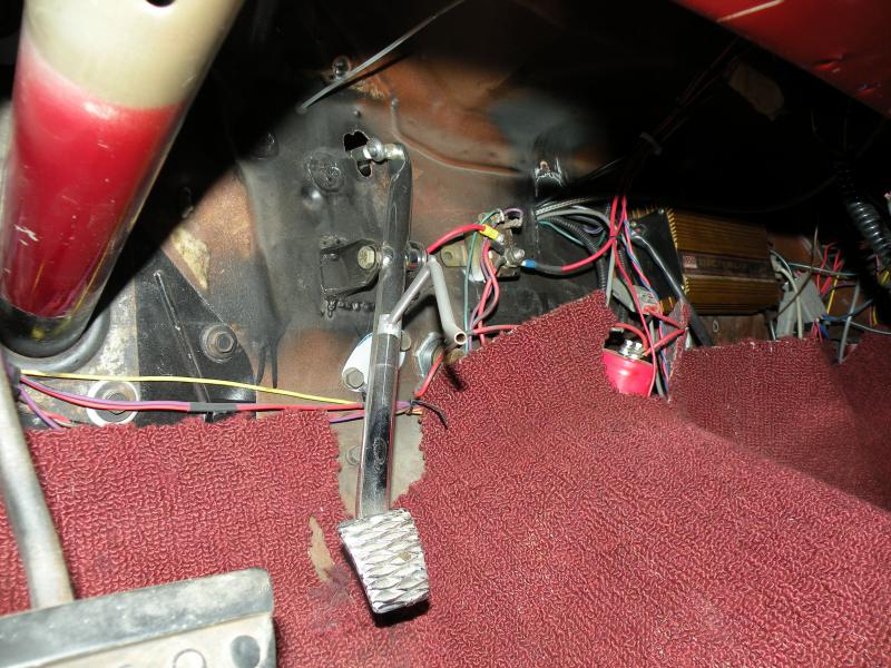

I just reread my post. Here's the STEEL gas pedal. Don't use a aluminum one. lol
http://www.rjracecars.com/QM-Gas-Pedal-314100-Prodview.html
http://www.rjracecars.com/QM-Gas-Pedal-Toe-Hook-Kit-2141031-Prodview.html
And then I bent up a 1/4" steel rod and put on welded rod ends on both for a nice sturdy feel.
I also did a 3/16" rod for my inline tunnel ram which worked out nice as well.

I also ran the 6109's on a 440 with a Weiand TR inline. Had to use the small bowls though but they worked great on a 10.60 car using a simple 'T' bar throttle linkage and stock pedal and cable.
Here's a few more pictures of my Tunnel ram throttle rod and gas pedal in my 65 light blue dodge
