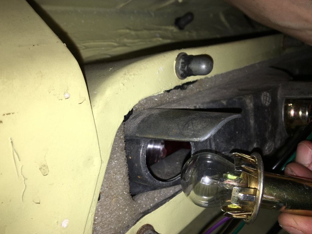

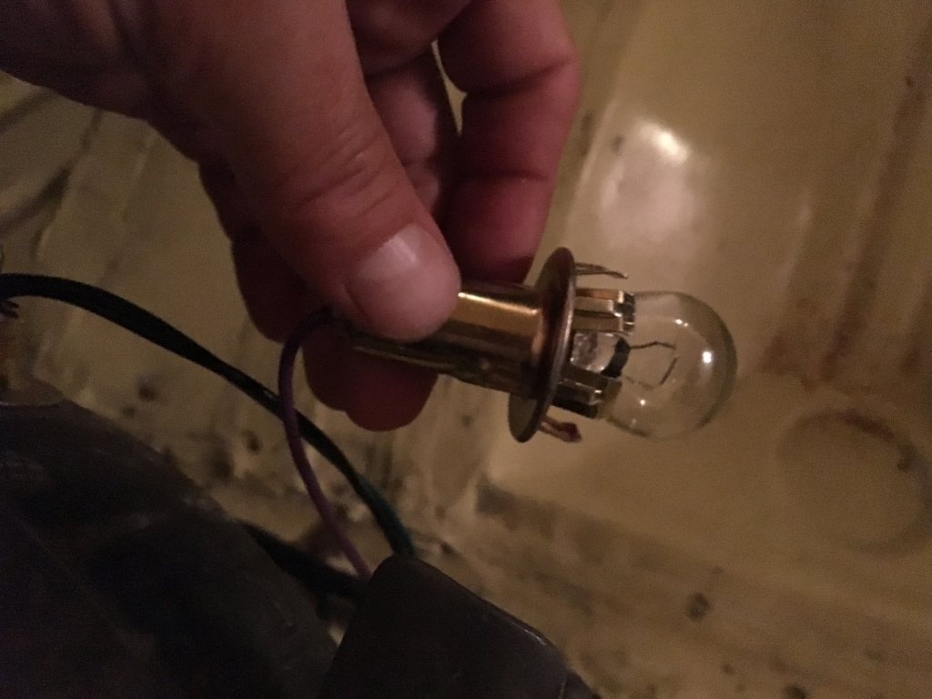

Is there a trick to putting the tail light bulb back in on a 1969 Coronet R/T?
You'll notice a gap in the "fingers" that hold the socket in place.That gap aligns with a notch in the tail light housing.
