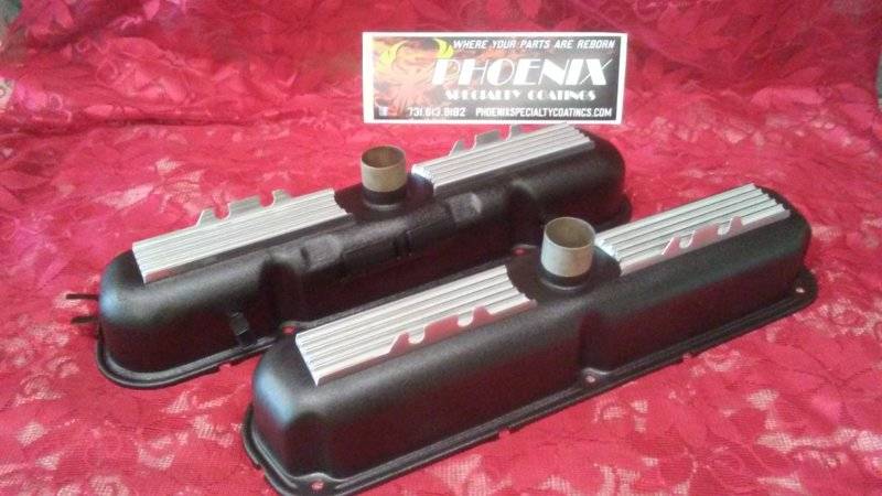

5.t7 Hemi polished my grille and I chose to keep it bare. Had my intake and Valve covers done locally and they cleared them. I will NEVER clearcoat again. Next time I have it apart I will remove the stained & peeling clear coat.

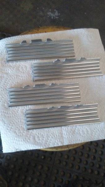

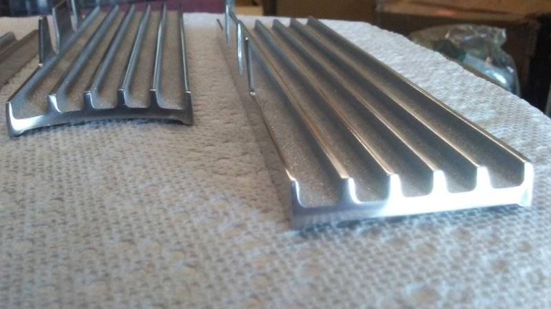

Here's a few pics Before to After, used on a set of REALLY rough aluminum fins for a pair of Commando valve covers. These belong to YouTuber Jed Scott if any of you follow him and his dad at Scott's Speed shop.
And now, straightened, polished, buffed and protected for a lifetime ...

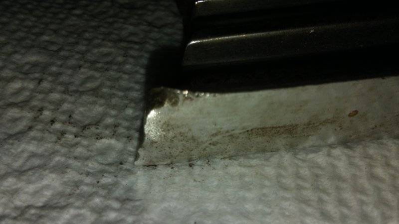

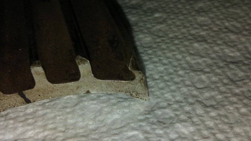

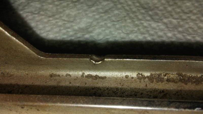

Le,,,how does that stand up to gasoline and hot oil? My intake and valve cover are both stained and the intake is peeling.

Thanks! Next time it's apart I will bring it back to them,have them strip it and REpolish it. If they refuse,I tow for at least 15 places that use them,,,,,,for now:elmer::elmer::elmer::elmer::elmer:
