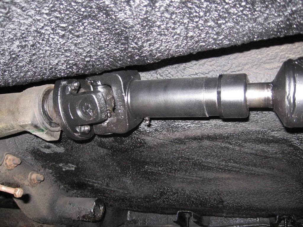

Taking Up New Residence
I'd rather have my nuts showing than run a chrome dust cap!!!
I coulda swore I put chrome caps on my dad's '59 Ferd Galaxie back in the day!I was probably 13-14?Looked pretty good then.

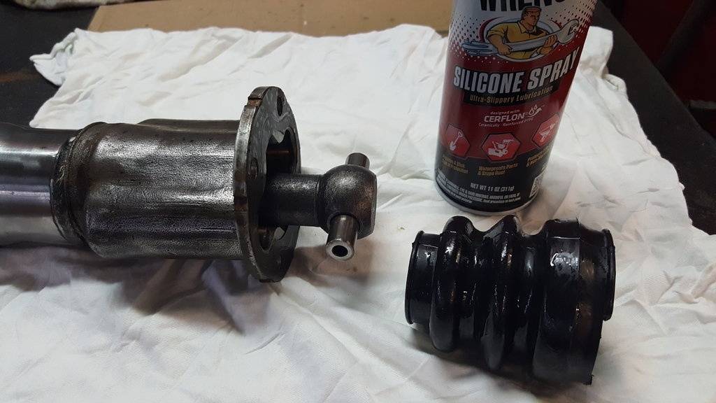

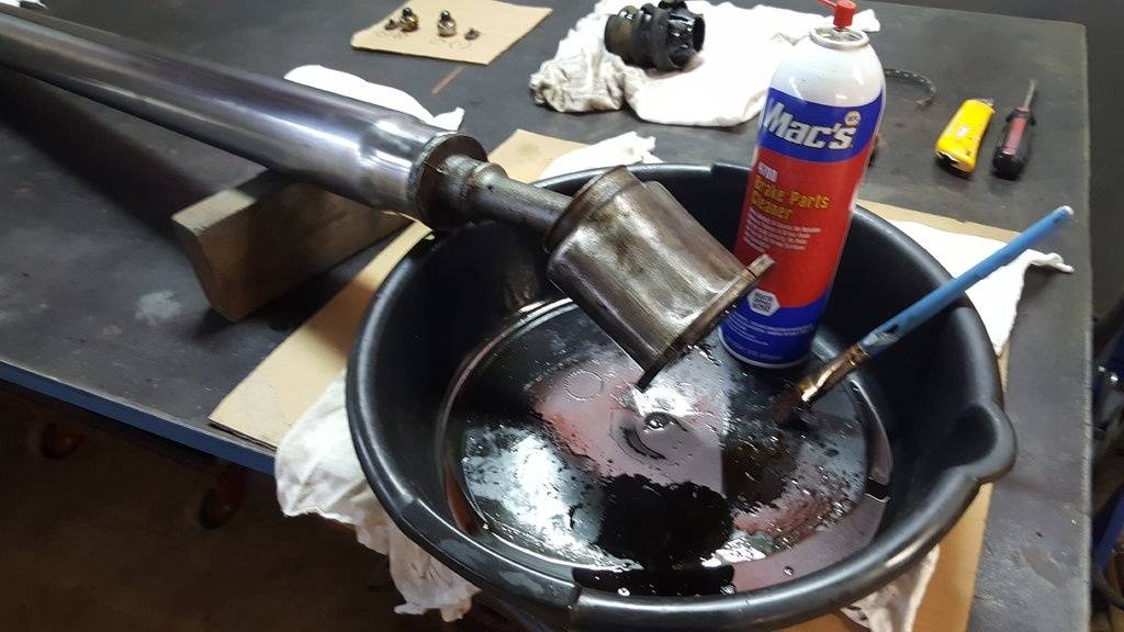

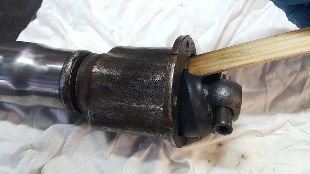

Clean everthing up real good then on to the new boot.
Useing a little silicone spray on the boot to help it slide. Used a paint stirrer to help push the boot through.

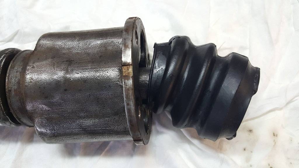

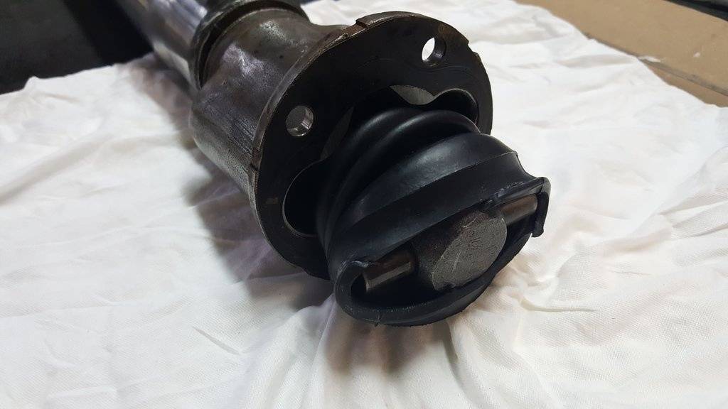

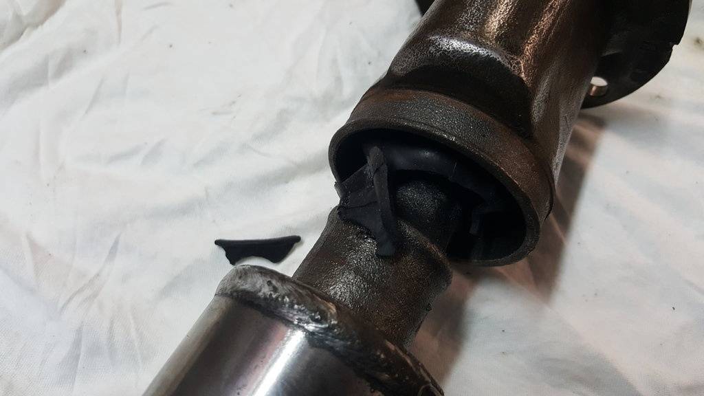

Got the boot started through the back, gave it a little pull and this happens! SON OF A BITCH!

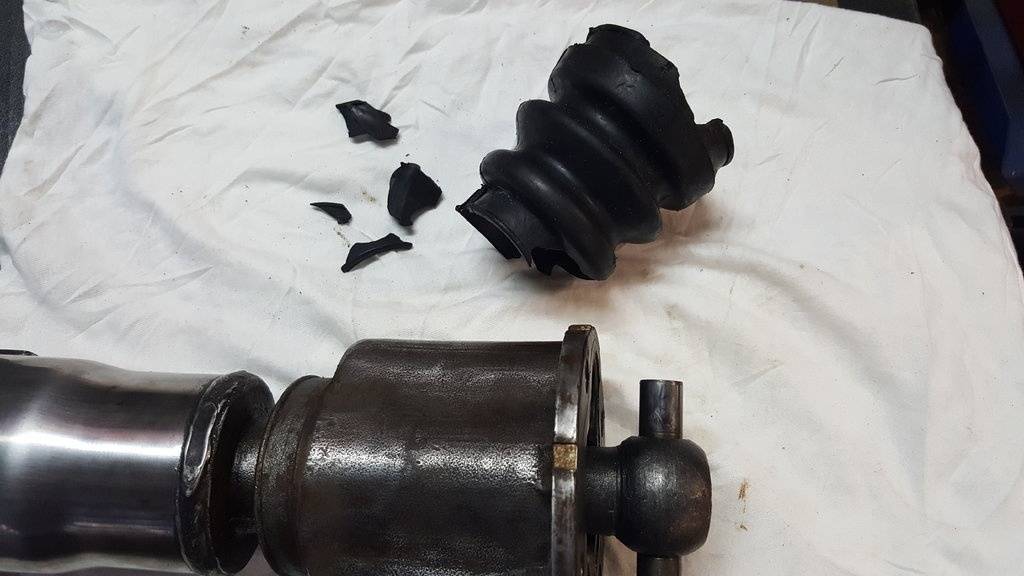

Cheap *** fn rubber. Probably made in China. It tears so easy. It will stretch about 1/8" and it tears. Tore the crap out of it getting it back out too. So much for my first attempt!

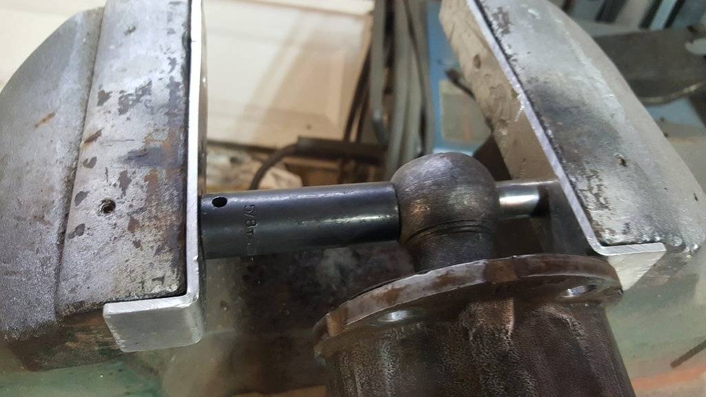

I even thought if the pin was to the one side that the housing might just come off. So I tried pressing it to one side but it wouldn't budge. I would need a good press for this one!

I commend you for doing this.Buy two kits(boots) that way your second attempt will go smooth.The other kit will sit on your shelf for the next 50 years ! I cheated and had this done

Have to wonder if there's any NOS boots around, or maybe a better make, out of a driveshaft shop? Or, a piece from a rubber supply house, with some kind of boot you could retrofit.

Good advice Darter. Yes the shaft modification is a good idea too. I've seen this before but maybe in the future.

I have another one coming, suppose to be usa. I'm afraid a nos might be compromised from sitting on a shelf too long?
Watched a couple of vids on YouTube yesterday and the one guy used a wire on each side of the boot to pull it through the housing. I'm thinking a large zip tie would be better than a piece of wire. Anyway it worked for him.
