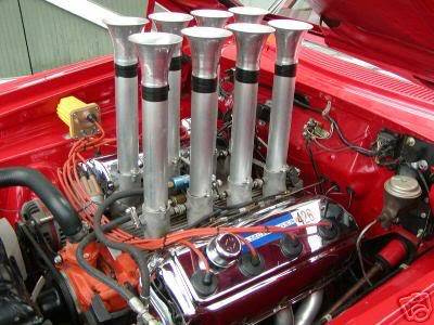

the 499 in the Duster would make it fly but I want to drive this one on the street and besides wouldnt a big ole HEMi with stack injectors look cool sticking out?
sorta like this...
Depending if you are going to run a mechanical or /efi Hilborn I have the people and sources for anything you could need or want. All with about min of 30 years EXPIRENCE EACH.
The fuel and feeding system is always the stumbling point for all guys wanting to run a "Hilborn".
Garlits makes a neat "fake system" that is cool, works nicely, and is street friendly. Only a close inspection can tell it apart from the real thing. Or you could try the KB/ 4 webber setup if you could get it to flow enough for the stacks look..It would be the less expense of all.
FYI
the tube length adjusts the point where the torque comes/kicks in, longer = lower
hint: on the roll bar halo floor attachment points....add out riggers also from rocker boxes to frame ties
I was thinking converted Hilborns to electronic...
