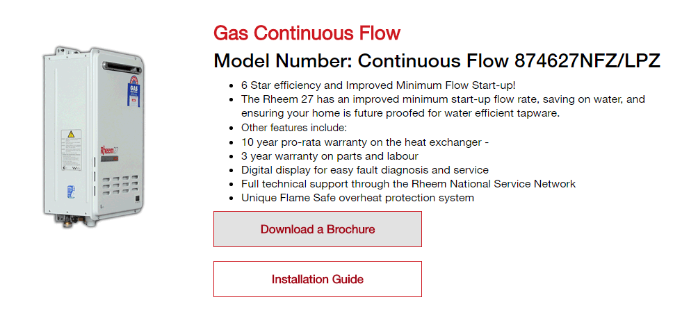

Just as a side note - this may be applicable to you guys in the US also....Water Heating accounts for approximately 1/3 of your Electricity consumption....so by installing an instant gas water heater, significant savings can be made over a year. :thumbsup:
mine is a power sucking hog! Want to switch to propane one of these days.
