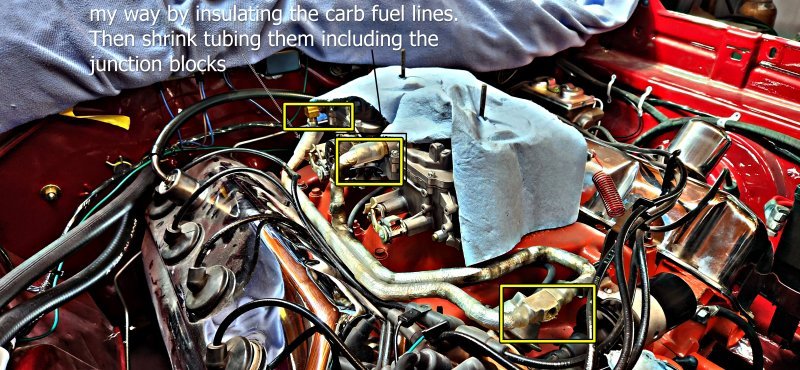

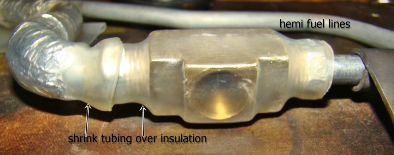

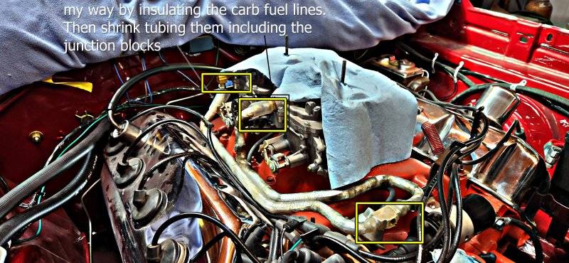

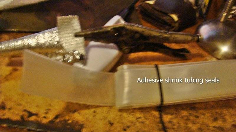

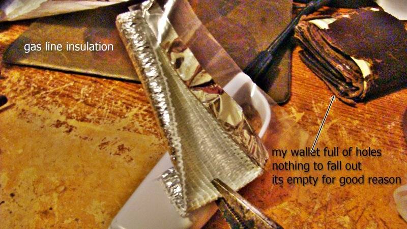

!cid_3dc81a24-e054-4f66-9a64-fa38b8678590.jpg4 23 23 003.JPG4 23 23 001.JPG4 23 23 006.JPG
i decided to remove the heat from the fuel lines so the gas wont boil as in all aspirated carburated vehicles...
I also have 3 feet of the same on the fuel line insulation.. past the exhaust manifolds.
I am just trying a new idea to make life better for the carburetor generation.... hoping this should help vapor lock too.
