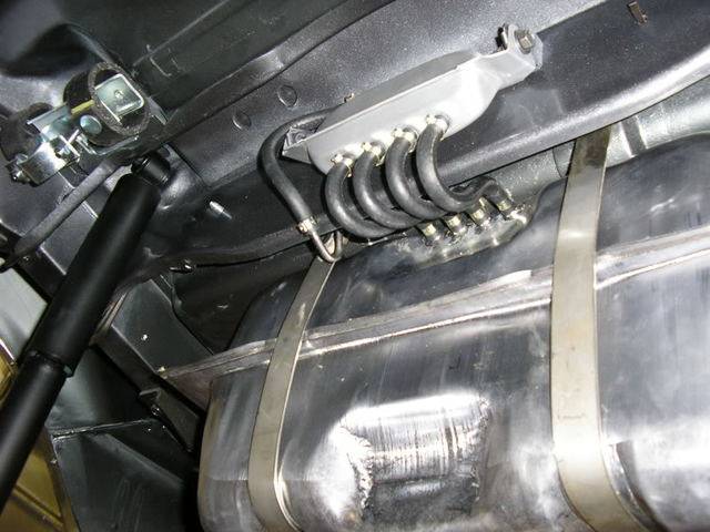

It's a coil roll over vent. I'm gonna remove the vent and check it for any foreign matter in it. Then again as Wild RT mentioned, the fuel would not come out if there were a clog.

Last question then you will have to let us know.. Is this a braided line coiled vent like this one?
Fuel Cell Vent Kit -8an Rollover Valve Vent Kit | eBay
Or is it like my vent I have on my fuel cell which is 1/2 inch aluminum line coiled? If it's the braided line maybe the line inside collapsing allowing it to build enough pressure before it blows it open and can collapse again. Kind of like how rubber brake hoses go bad but look fine on the outside...

Just had a thought, do the coils of the vent stand up or lay on their side? If they are standing up they can act as a one way check...Pull the gas cap and blow compressed air through the vent line.. It could be fuel is trapped at the bottom of each coil not allowing the vent to work... Re-position the vent so it lays on it's side & creates a constantly climbing spiral so any fluid drains back into the tank..

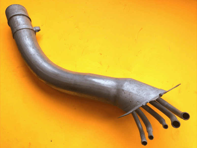

Here are the different valves (ball valves?), separators?, he used...
This is the one for the vette that he just mounted above the tank for the mustang:
70-74 Fuel Separator Vent Vapor Valve At Gas Tank

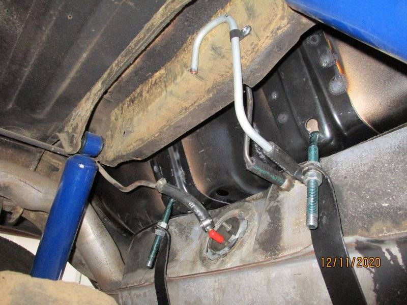

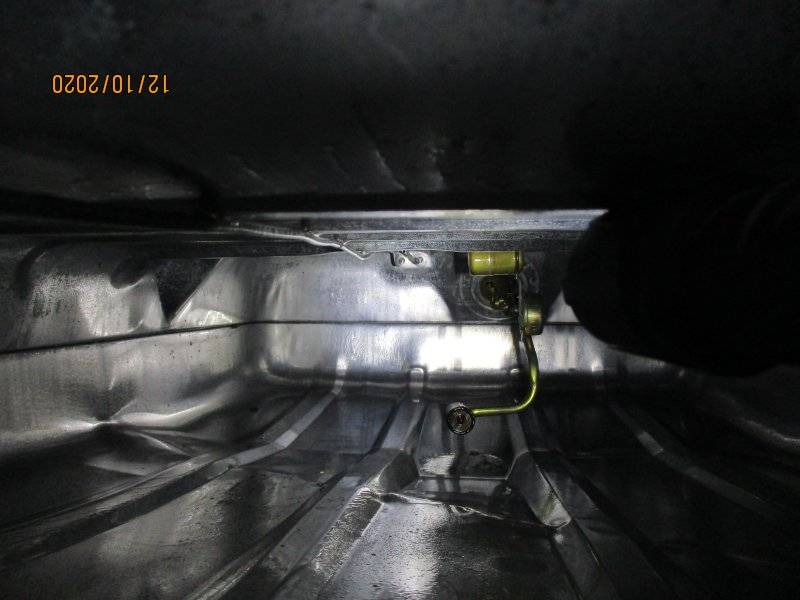

Does your fuel tank have two vent lines like some of the OEM tanks (like 1969)? If so, one is short and one is long. My 1969 Roadrunner aftermarket tank had these reversed. The short one should vent through the long tube that routes through the trunk. The long one (that goes to the rear of the tank) vents under the car through a short tube. If these connections are reversed, fuel will dump out the short vent tube on deceleration.
