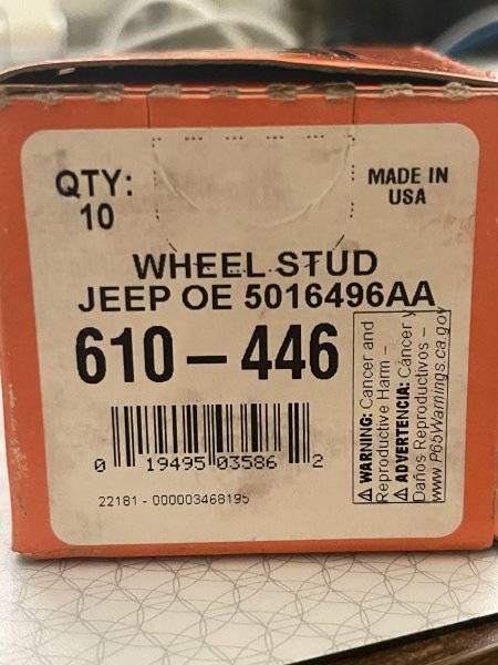

For those of you that are keeping their taped axles in your early "B".
Dorman #610-446 with a .684 knurl is what I used.
Switching from left hand or wanting longer than stock, they are longer ( under head length 1.938 ) for those that may be using aftermarket aluminum wheels.

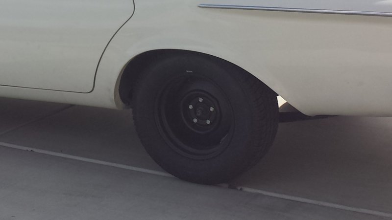

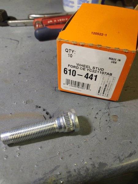

I used #610-441. They are also longer, worked out great. Ford OE YC2Z1107AB. This was on the rear, tapered axle hub, with 65+ drums conversion.... I'll find some pix and update.

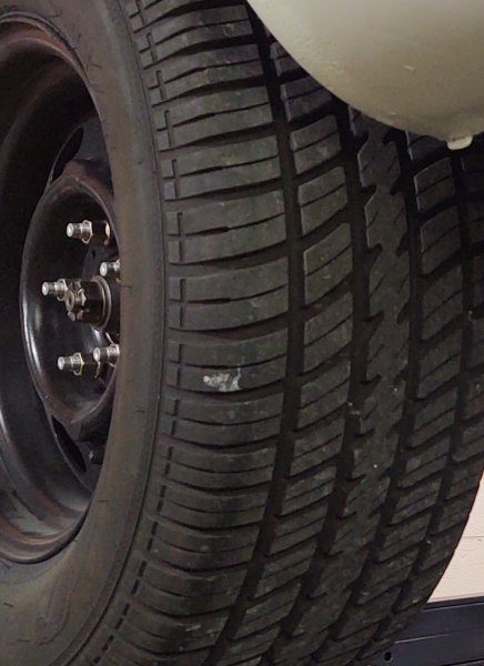

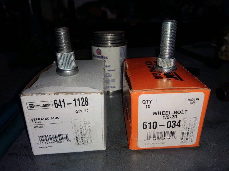

There was an online guide that suggested using the NAPA studs, but the ones they gave me with that part number had a knurl that was crazy long and actually hit the lug nuts preventing a tightened wheel. The Dormans solved this.
This is the one I ultimately used, pictured above with the wheel mounted;
