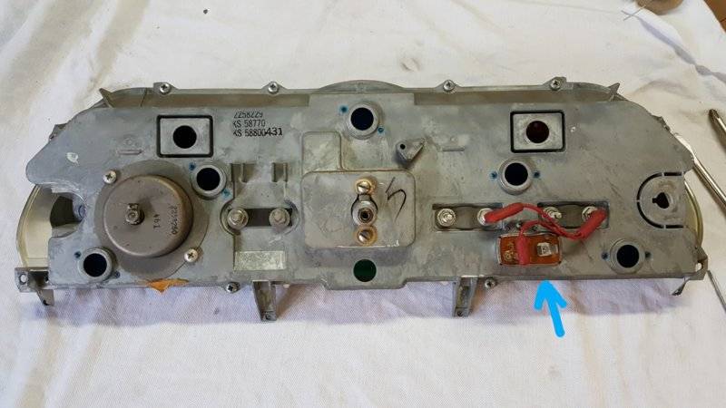

Think you have a defective 5 Volt mechanical regulator since the 3 gauges you mention spike like that. Not sure where it is physically located in your car. Anyways, find what you need here.. https://www.rt-eng.com These are the best way to solve Mopar gauge voltage regulator problems. Don't run the car like that as frying all 3 of those gauges is possible !!
What they said...voltage limiter.
Should look something like this...
You could steal the one off your other cluster.
