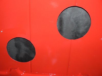

Max Wedge Hood Openings for Carb
Here's what Mosher has on their webpage. Not sure it's exactly correct? No mention of a Template-
