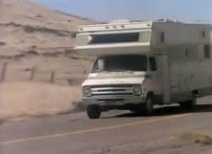

A ma Mopar feather....had a 74 Tioga with 360 2 bbl.....out here on the 405 around s San Pedro 110 exchcange,,the 405 in both directions is absolutely flat....with 4:10 gears, i could get about 110 either direction......a broken right bank exhaust manifold, sounded like a radial.....360 is supposed to be out of breath @ 5500 rpm, Right??....this thing just wanted to go...had a Sun Tach where the red marker was Happily Set @ 6500 RPM!! i am not lyin...little stock mouse just said ....
" I Cant Drive Fifty Five!! "
I could hole shot a Lexus IS 300 across an intersection too.
