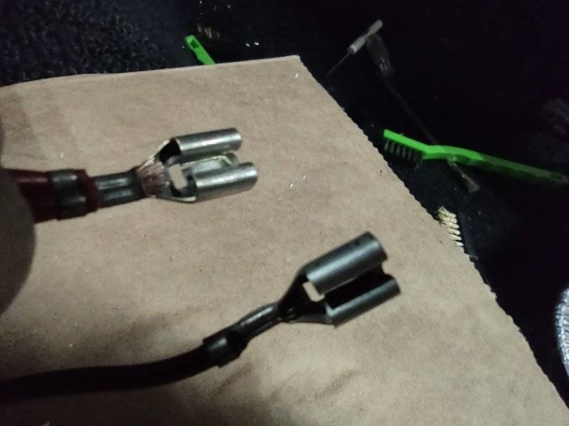

I take each connector out of the plug, clean them with electronic cleaner. I use a brush and clean them well. Crimp the spades and reset the lock tab. Coat with dielectric grease and reinstall.

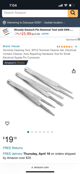

Someone posted on here a special two sided file. I should have info. goes to original poster. I believe it’s on Amazon
I ended up removing connectors out of bulkhead plug. I used baking soda paste, along with white vinegar to remove dirt and light corrosion since no one had deoxit locally. I also used brass and stainless steel brush to clean. Rinsed with wd40, dried off with compressed air, reset lock tab, light film of dielectric grease and reassembled. Way easier than I thought, just took me most of the day. Returned files to Amazon as not needed. Thanks everyone, your help is much appreciated!!!

Technically, they aren't Packard connectors. The crimping method is the same but Packard 56 terminals have a folded-back lip that scrubs the male terminal and provides a better contact with the male pin. The wrap-around sides on a Packard terminal are square whereas the MoPar terminals are rolled over.
Packard 56 terminal
MoPar (Amphenol style) terminal

I got my files the other day, was not impressed, I would not recommend them.
Good thing they were not very expensive.
