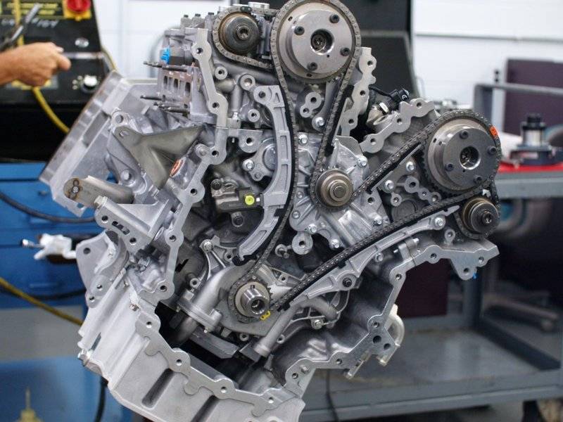

Here's a little quiz...can anyone spot the inherent design flaw in this file blue oval engine? Here's a hint: An $80 part failed (a part that commonly fails) in mine and cost me over 8K.
They have since redesigned it.

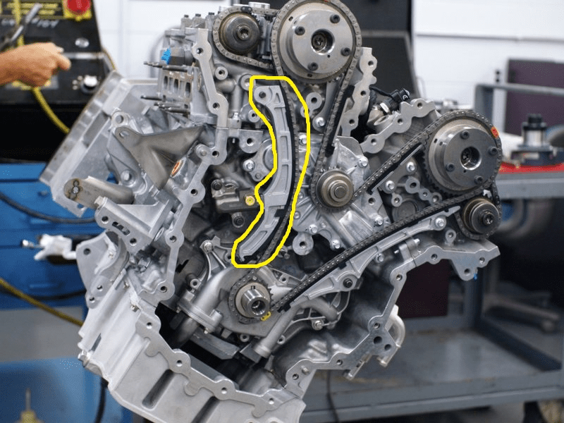

I'll guess this part circled....too much friction from the chain and not enough lubrication at higher RPM's....
Unless engines turn backwards down under, that's the slack side of the chain. Good try though.
With the earth's rotation and southern trade winds, I expect it would go the opposite direction. :p
If it's not the cam chain tensioner then maybe the yellow link in the chain (although that wouldn't be $80 surely). My guess is related to the cam chain in some way, either becoming slack or snapping, with resulting valve/piston interference. The Ford DOHC in Australia used plastic tensioners originally, until they started cracking.
The hydraulic chain tensioner would be my guess.
Water pump. Did well over a dozen this year alone.
Ya that's a stupid place for a water pump. Of course Cadillac put their starters under the intake in the valley. :BangHead: GM's experimental division. LOL

I’m gonna say cam phasers and timing chain. The one in my driveway needs both...

I'm going with the water pump, man is that the most ignorant place I've ever seen one mounted!
Winner Winner! Although it sounds like you have an unfair advantage.
