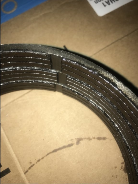

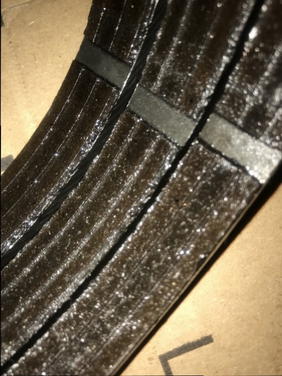

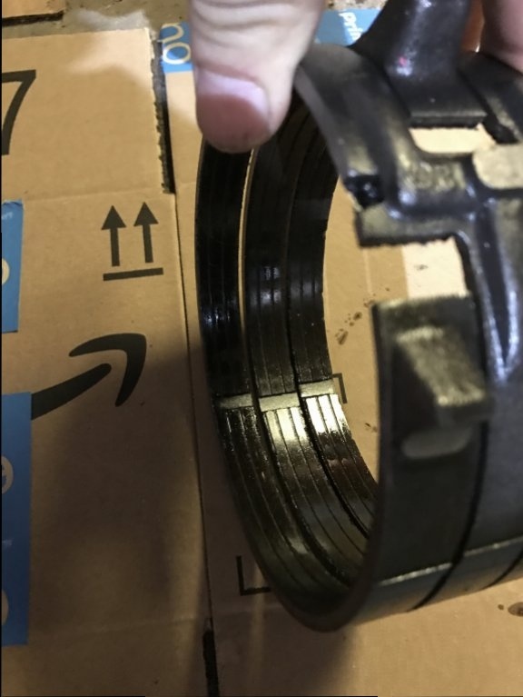

The low reverse band is not included in the kit that I purchased. Would you recommend always replacing it or what are the signs that it needs to be replaced. Photos of band are attached.

Rear band has two functions. Reverse and 1st gear trans braking. Unless they're physically broken I've never replaced one.
Doug
