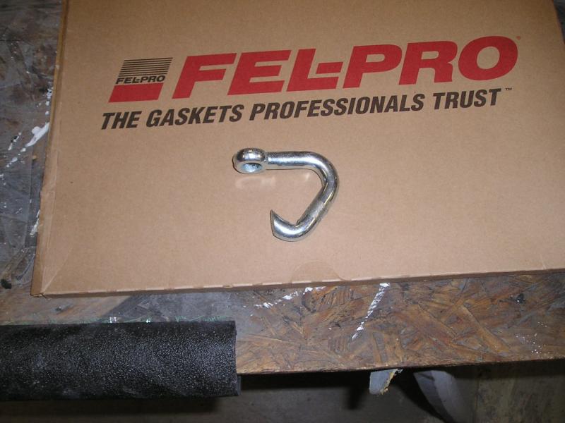

That's nice, but what the hell is it ? 3.0
Its not a hook its a chain link.... hey I got half of it!
Now the sky hook... it doesn't make any sense with the other part.

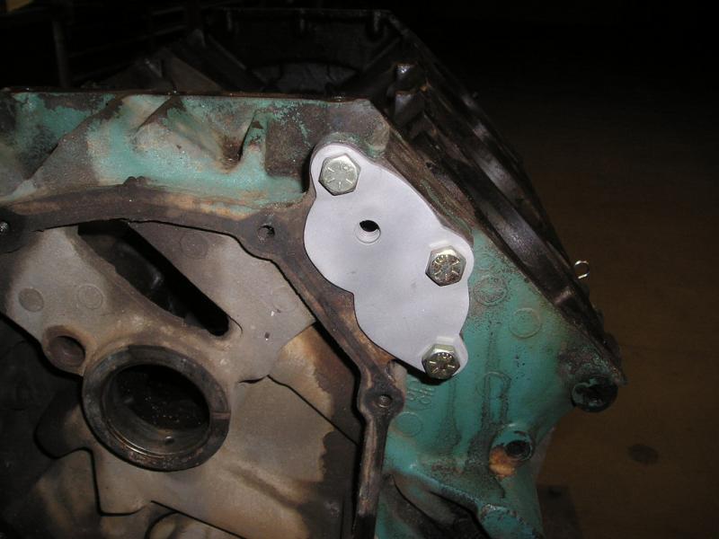

Bolts to the side of the motor mount to attach your torque chain to?
Or bolts to the end of the head for a lifting bracket?
Frambulator autoadjust bracket for the Gen III flux capacitor?
This one's a piece of cake...our friends super-bee_ski and Budnicks should be at least two who understand it usage....

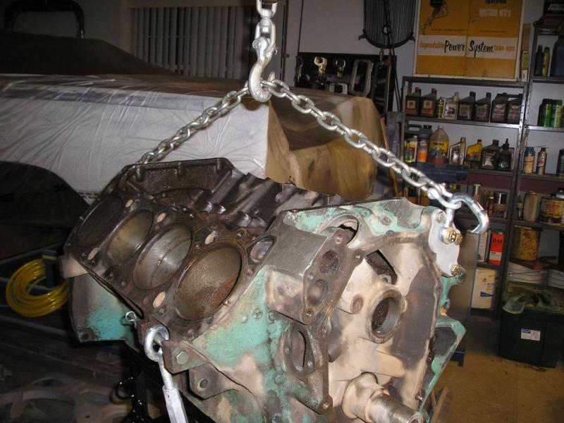

Another variation....
Okay, okay, I'll let you fellas off the hook, metaphorically speaking.

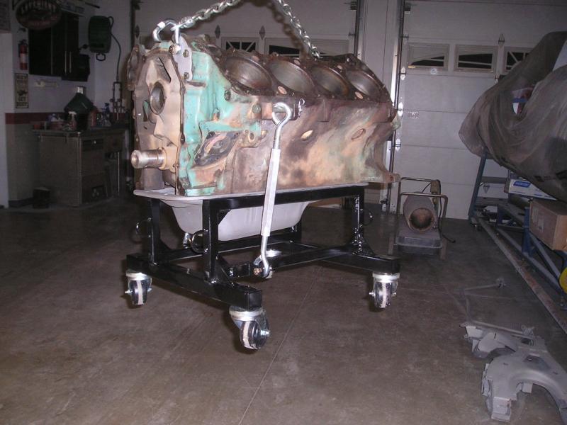

I was getting ready to ship this block out for machine work when, in my innate desire to over complicate everything, hit upon making this bracket hook combo whereby to lift the engine from. The usual 3/8" bolt through the end of the head wasn't an option and the top hole for the water pump passage doesn't have a lot of meat behind it. Using one of the lower holes meant the hook would be digging into and already imperfect sealing surface. Yes, it's things like this that make a one year resto turn into three. Thanks to all who played.
Props to Seax440Dodge and KhryslerKid for both being half right. A boot for each of you.
Very nice! I was trying to figure out where that three hole bolt pattern was from.Thanks for sharing and the game too!
