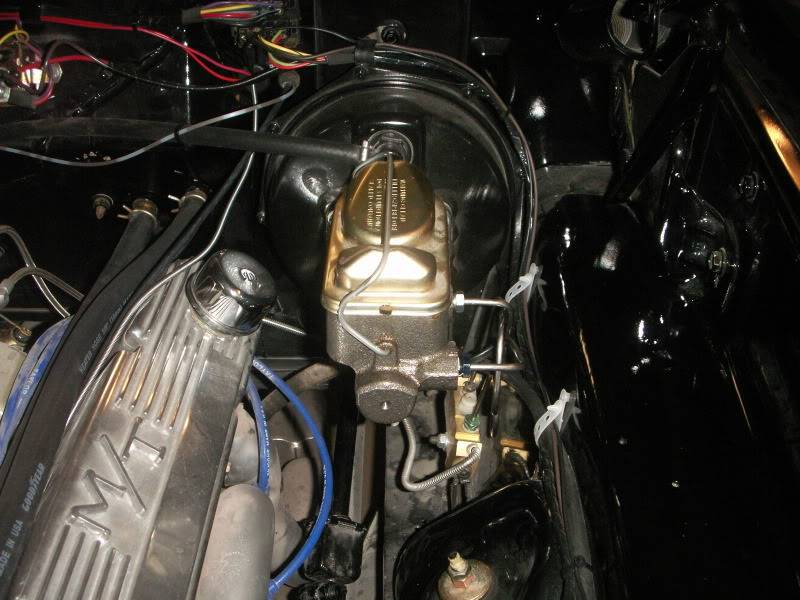

Can someone tell me if there is an adjustment between the master cylinder and the power booster for adjusting the length of the push rod?
Also is there anything to watch out for in unbolting the master cylinder from the power booster that would be under pressure by way of springs or something of that nature.
I'm thinking the rod is not quite long enough to make the plunger go all the way to where it should be going and therefore leaving a pocket of air.
Make any sense?
This is what I'm working with.
Baby has brakes!
Well I decided to remove the master cylinder to take a look, and yes there was a adjustment nut there which I turned out a little less than a 1/4" and reassembled it back together. Then I bled the m/c and wahlah great pedal.

That is exactly what i had to do today, I cant believe the difference. Now I got the "whoa" to match the "go".
Well had to take the master cylinder back off today as the brakes were not releasing far enough. Backed off on the adjustment and seems o.k. but I may have gone a c-hair to much I'll wait and see how it feels on the road.

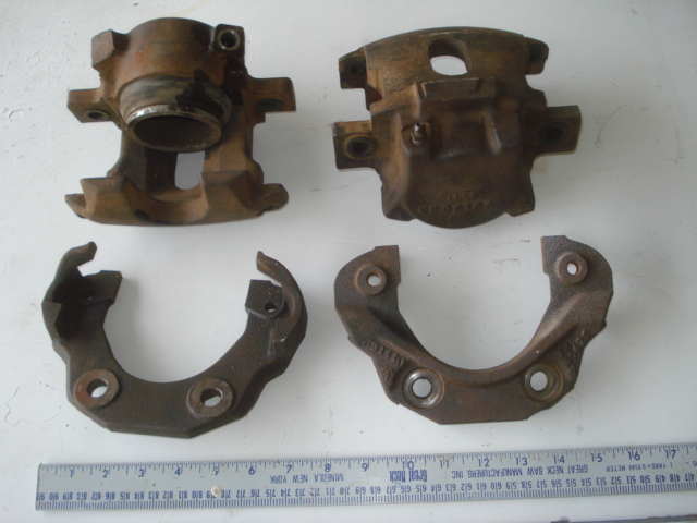

Well still not happy with the way the brakes felt I had the mechanic check them out today while getting the front end aligned.
Here's what he said, hope I say this right.
He had to undo the calibers and turn them upside down to bleed them cause he says the bleeders were at the top position and should have been at the bottom thereby making it impossible to get the trapped air out of them. Then once bled he turned them back over and remounted them. Maybe it was the other way around. LOL :head_smack:

Air wants to rise so the the bleeder needs to be at the top, are you sure Joe that you heard him correctly? Could it be all the excitement of getting ready to drive your beast for the first time that ya got confused? lol!!!!
Well then.............Not sure about hearing him correctly (age thing ) and definitely yes on the 2nd part. LOL
