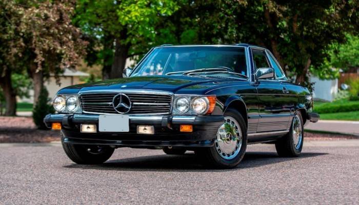

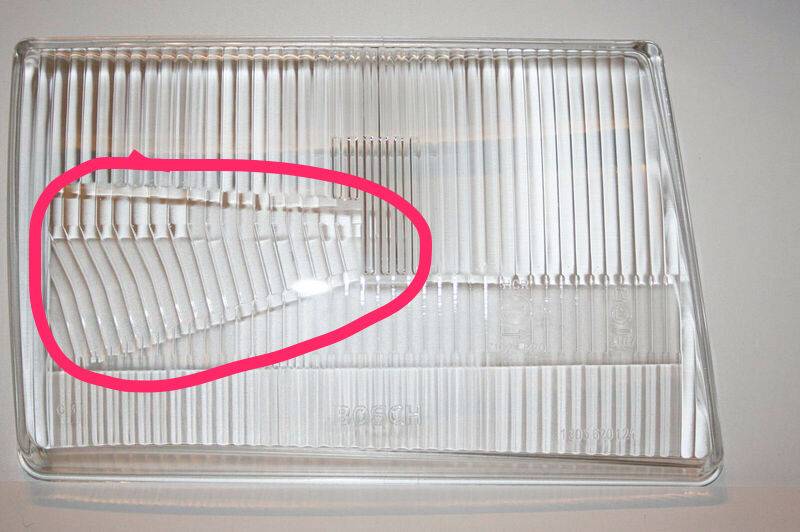

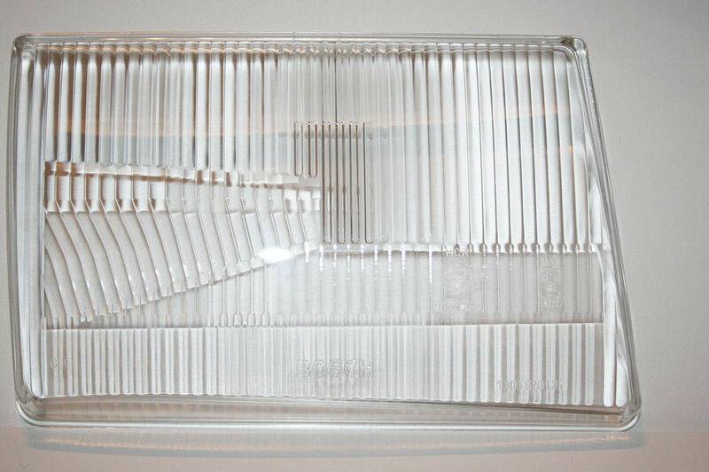

to keep the Mercedes example, which is the one I know better... here is the R107 lense for RHD

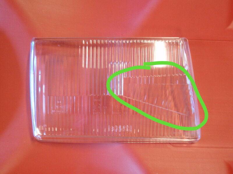

and here is the same for LHD
and both are Bosch... so is not a manufacturer difference

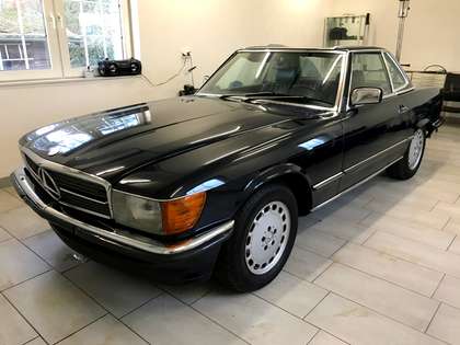

For those who doesn't know what an R107 is:

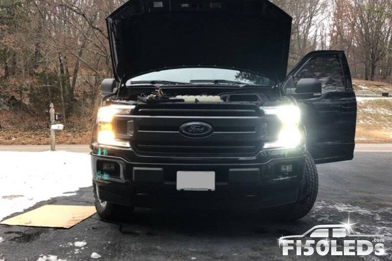

Like the Super duty Quadbeam option? All 4 lamps on in low beam! They will melt eyelids off in bright mode. I bet owners get flashed a lot....and NOT the good way.

If the headlamp patteren was controlled by the lens, wouldn't they be sold as a right and a left? I've never seen this yet in the US. Are those Benz lenz designated R and L ?
Both I used for the example are right side lense intentionally to not get confused about the side of the car the lense is, but one is for left side of the road drive ( RHD cars ) and the other is for right side of the road drive ( LHD cars )

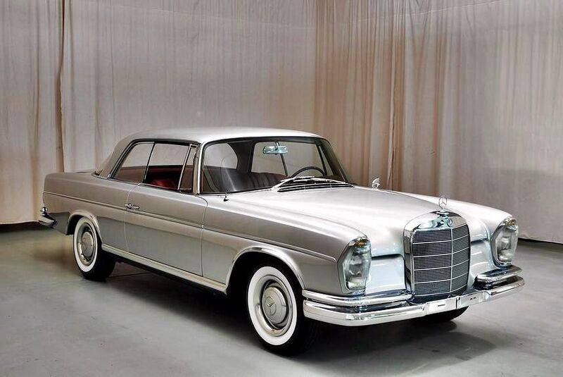

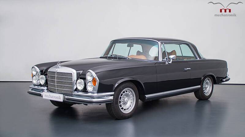

Up to 76 where USA regulations didn't allow the square headlights design, Mercedes for USA market got round sealed beams inserted on Mercedes ( and many other overseas cars with same setup ) original square screen design. Talking about the R107:
It happened the same on earlier Mercedes with vertically oval headlights.
i.e.: W111
where the original model is:
Aside the diff headlight setup, USA market Mercedes got a divorced road lamp and parking light... you can see them on the R107 and W111. This is not on the REST OF THE WORLD version because the headlight assembly on these gets all the lights into the reflector assembly, behind the screen. Even turnings are hidden by the lense on the W111. Not on the R107 thought
These cars and parts were built specific for the USA market. When the square lights were allowed in USA by 76/77 year, you of course allways got lenses made for LHD cars ( right side of the road ) so of course if you go to a LOCAL parts shop will never found RHD car parts available off the shelf.

Attached, the difference betweem lenses for RHD and LHD but once again BOTH are the SAME SIDE LENSE on the car
I can post pics of left side lenses ON THE CAR with same diff for RHD and LHD cars, but really need to? Of course the lense for left side OF THE CAR, will match the same pattern on the lense on the same side.

Well, just in case here I post the pair, both left and right CAR lenses together for the R107
but RHD
and LHD
