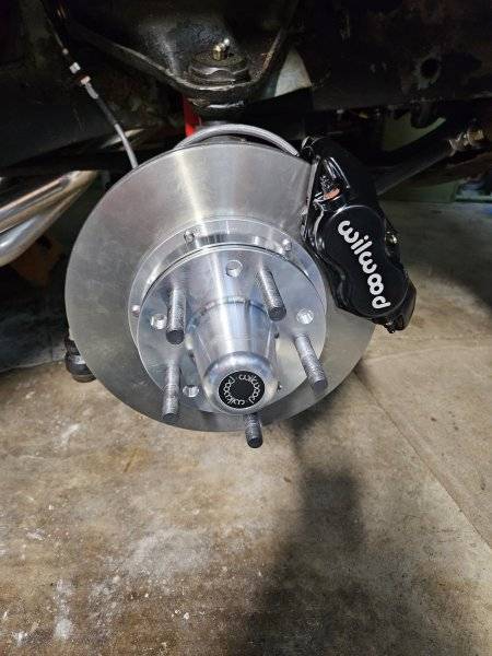

Trimmed about 40 pounds off the Savoy with new brakes.

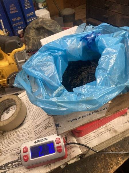

2 lb 7oz Undercoating and dirt removed from front suspension and steering parts during front end rebuild.

They were removed from a 73 Charger parts car. I have my notes at work where I weighed them but it was just under a 40 pound difference. I was shocked when I weighed the new brakes at 17 pounds for rotor,hub,caliper,pads,and bracket. I think the rotor alone on the Charger brakes weighed almost that much.

I raced my Savoy for years on 10" drums and that was fine unless you get lucky and start going rounds. My home track had a very short shutdown lane so my brakes would get hot and wouldn't stop well after 4-5 120 stops. I have Wilwood Dynalite on the rear and Dynalite Pro now and I'm looking forward to see how it stops at 127.
